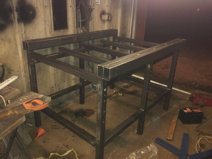

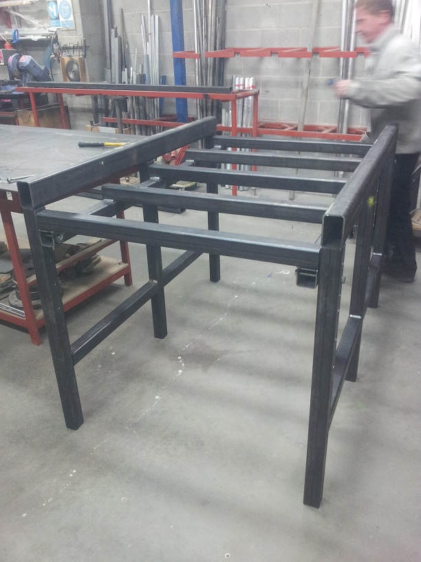

01-12-2012 #56
Right then gents
a productive day... Good friend of mine lent me the use of his unit... which was invaluable square warm space with all the kit to hand to make the job of making the frame easier.
Not to mention a fork-lift to load it onto the trailer to bring it home!. My god its heavy.
60x60x4 box & 60x100x5 box
Very pleased with my welding.. Proud enough to upload a piccy. Got so used to welding on crappy tin underneath cars welding nice clean think steel was a dream!
and finally; back to my comparably dark and dingy untidy workshop.
"I have a new crown"

01-12-2012 #57
Looking good Julian, looks like your mates unit is the business!
Welding up cars made of tin....I hear that, how comes you dubbled up on the top rails ?
EDIT: Scrap that question just went back to post #31 for a recap !

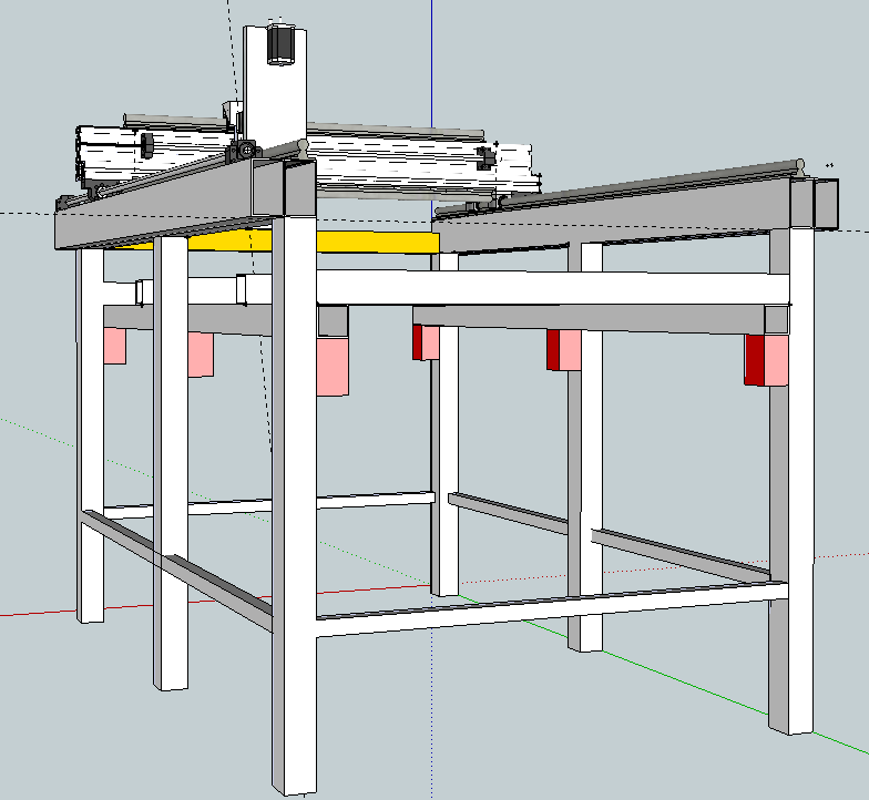

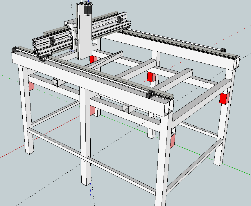

02-12-2012 #58
ok taking on board jonathons comments; ive redesigned Y gantry to bring Z closer. feelings on this?
ive also taken the sound advice of a very nice chap; who pointed out I should add some extra bracing at the top to reduce resonance; At present I can only guarentee space for the yellow peace... I need to think of a cunning place to put one at the other end. the obvious place would be between the two 60x100's however that is going to be RIGHT in the way
Ive also added the red-blocks... the idea of this is to support the bed bolts further. Its suspected the bolts will move and the bed will constantly go out of true. Therefore the idea of these is to re-inforce.
however, ive since had a brain wave.. stand back. the idea of the multiple holes on each leg is so the bed can be lifted and dropped. well... how about instead of the small red peaces; I have 6 metal peaces pre-cut same length per height adjustment... so imagine the red bit going all the way down to the horizontal cross bracing.. only drawback to this idea is that I need 6 bits per desired hieght; but the advatage is the plunge force onto the bed is directed down onto the horizontal beams (which in the drawing are represented as 30x30; when infact they are 60x60x4's
eagle eyes amongst you will also notice ive switched the Z screws round (so the belt and stepper is at the other end).
anyway; been building cnc all day yesterday and new shed all day today (long story) in the freezing cold; Time for a beer and to fall asleep in front of the telle
work tomorrow.. dredd.
Who can I Pay to supply cut and machine all ali plate bits for the Z and Y this side of xmas? none of them are complicated no pocketing. just straight cutting (well straighter than me and my angle grinder can do!)Last edited by kingcreaky; 02-12-2012 at 10:26 PM.

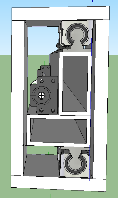

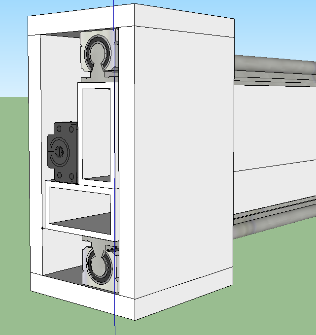

10-12-2012 #59
Hi All.
Im aware that mounting the ballscrew behind the face is a compromise, however. Based on the gear ive got here I cant pocket therefore this is my final gantry design.
The gantry is made of two 60x100x6 Ali Box Sections bolted together.
The Y face plate is 160mm wide
before I spend a sh*t tonne of money with Aluminium Supplier | Aluminium Stock | Aluminium Warehouse (excess £200) on ali; can somebody tell me any good reasons why this wont work (it maybe revised at a later date once the machine is made)
also; do you think ecocast is necessary for anything other than the front plate... for example the top & bottom bits and the back plate can surely be 6082?
thanks in advance for the influx of replies...
^^ or... turn it round? so the Y plate is at the back?
10-12-2012 #60
Make the 4 joints on the Y plates the other way round, otherwise you can't adjust the vertical spacing of the Y-axis bearings to account for any error in the box section dimensions.
You don't really need eco-cast for these parts, so long as you use cut aluminium plate not flat bar since the error on plate is tolerable when you're only using round rails.
Edit: You could also make the plate on the back thinner as it doesn't contribute much to the overall strength.Last edited by Jonathan; 10-12-2012 at 08:43 PM.
