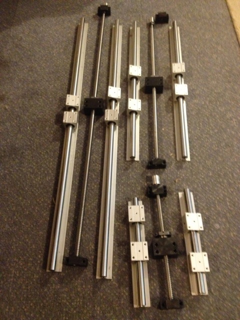

    Blimey a big thumbs up to Chai, unbelievable service, guess what turned up on my doorstep this morning, all the way from China, less than a week after ordering?
Name:	Present From Chai.jpg
    I was like a kid at Christmas this morning. Only problem now is that I was expecting it to take at least a couple more weeks to arrive and hopefully I'd have been well on the way to completing some sort of design! Which I haven't!

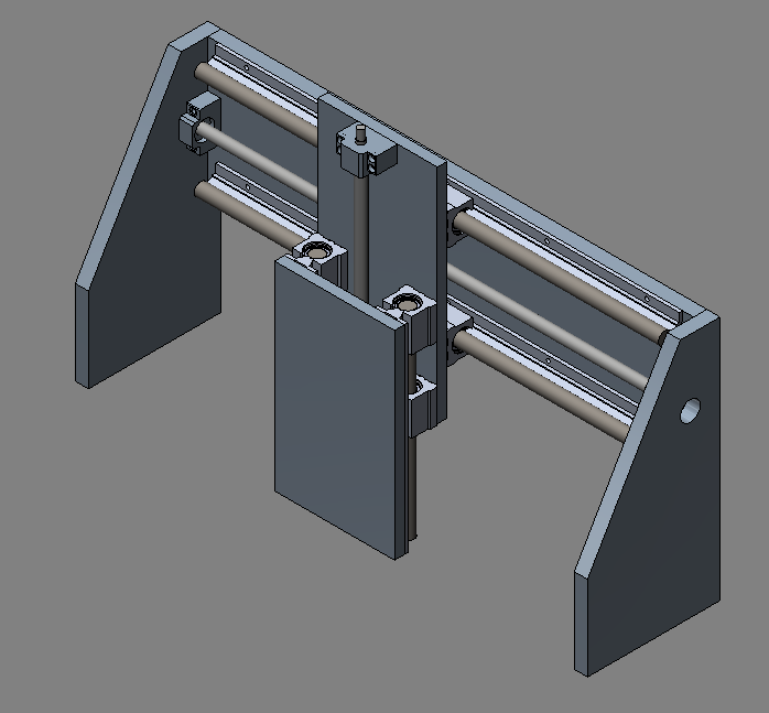

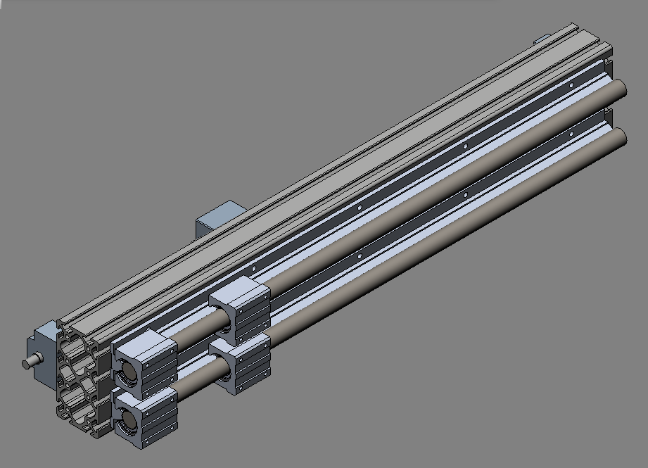

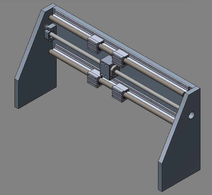

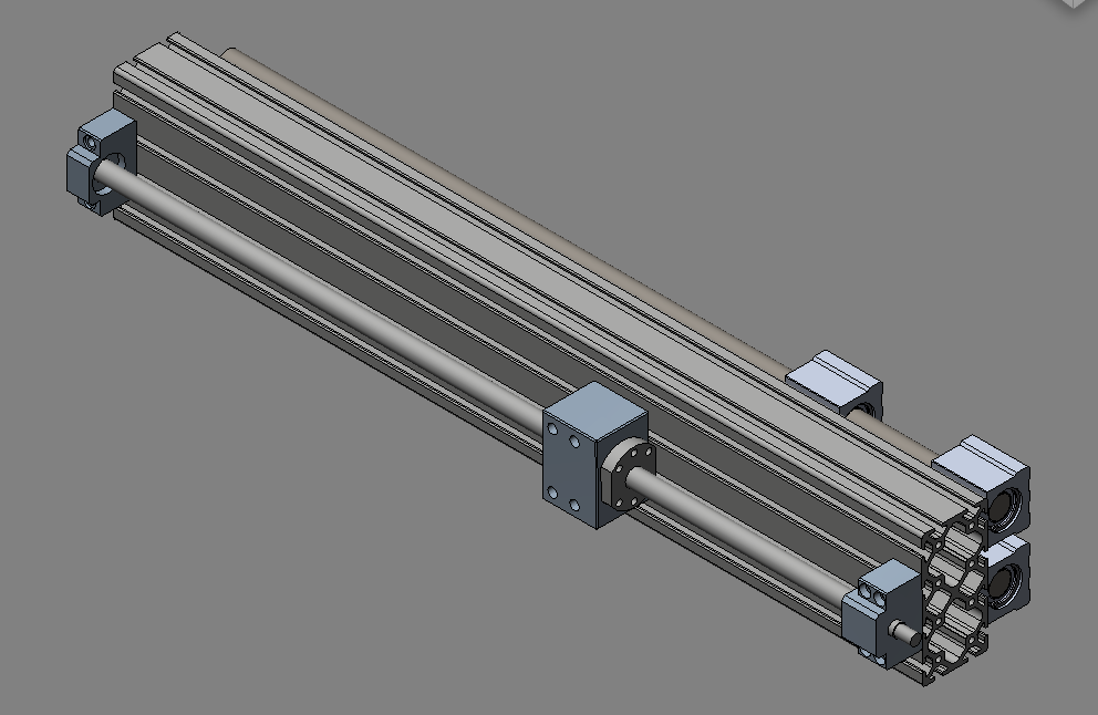

    What I have managed to do is think a bit about my YAxis, and have come up with a couple of ideas, nothing revolutionary and not anything that you'll not have seen before, and this is where the questions start to flow.
    Up until now I've been hoping to use aluminium extrusion, for ease and simplicity, but having another browse through the other builds got thinking about using aluminium plate. Is there any advantage of using plate? On my second design in the pics attached to this post I think this would work better with aluminium plate, instead of using the extrusion and then I was thinking I could move the ball screw onto the same side as the rails. My only concern is the extra cost involved in getting the pieces made up. What are the comparative costs in buying a 750mm length of extrusion and say a 750x300x20mm plate? Is 20mm thick enough as a back plate for a Y Axis?
    Of my two initial ideas below I'm leaning towards the first one as it just looks stronger, but am all ears as to any thoughts, advice on improvements, amendments, materials etc etc.

    From the picture, unless it's a twin start screw, it looks like you got RM1605 for the longest screw, not RM1610. Assuming the ballscrew is 1150mm long, as per the original post, this will limit you to about 8.5m/min due to the critical speed. That speed is plenty, but I doubt you will get it with 3Nm motors unless you have a 2:1 ratio between the motor and the ballscrew to get 10mm 'effective pitch'.
    20mm is plenty thick enough as a back plate for the Y-axis, so long as you have some box section or extrusion bolted to it to increase the strength parallel to X and the torsional stiffness. It will be much more rigid if you have the ballscrew directly between the rails, so on the same side is good.

    Learning myself so could be wrong but from what I have seen & read ally plate on it's own won't be enough for the gantry & you will need some extrusion or box section fixed to it.
  7. #16
    Hey Martin, yes I think you're right. Jonathan also mentioned it in an earlier post on this thread. I plan on bolting a bit of steel box section across the backplate of the gantry to give it that extra rigidity. Do you know if that applies to the sides too?

    Quote Originally Posted by hoppo View Post
    It would certainly help, but even better would be to lower the gantry as much as you can and have the tool operating below the level of the X-rails.
    Was just about to order some aluminium plate to start building my z axis. Had a bit of a panic. Is 15mm thick enough or would I be better off using 20mm for the sliding part and the back plate?
    15mm is OK, but most use 20mm as you don't gain much by going above 20mm. In the whole scheme of things it's not going to cost too much for the extra 5mm...
    In answer to an earlier question - standard 6082 is fine for supported rails. Tooling plate is only really worthwhile for proper linear guides.
