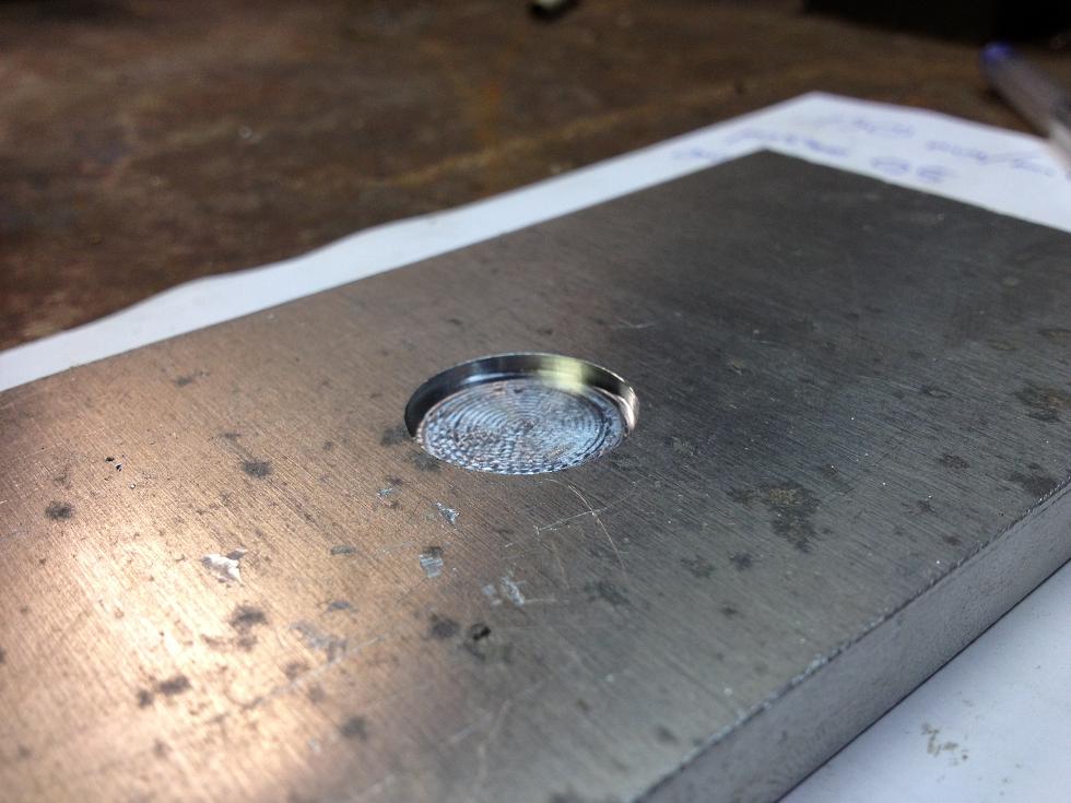

    Ok, he has sent me a photo of ali he has machined today. Youtube video later today I'm told. I might then get to see some of what this machine is capable of.
  7. Hard to tell from the resolution of the picture but seems to me the finish is useable but not great. Would be interesting to see the video and get some idea of the machining time and the tooling used.

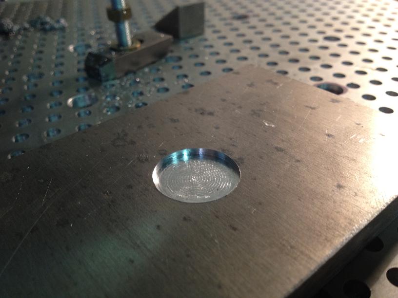

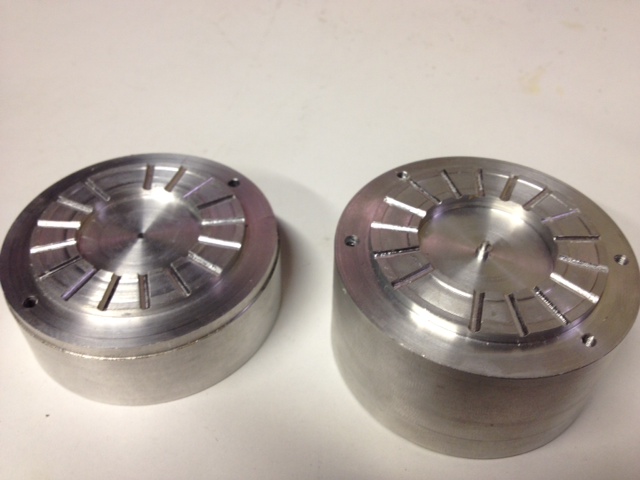

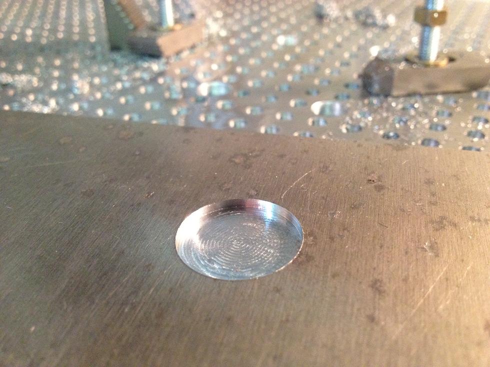

    I have chosen to buy this machine. I know it would have been better to build one for the amount of money spent, but I wanted a working machine that I could improve as I go. I understand it is never going to be a high performer.
    My question is please.....do I buy a Kress 1050 FME to replace the very underpowered 250w spindle that exists on the machine, or do I change the Z plate and buy a Chinese water cooled 2.2kw spindle ?
    Is there anyone online who fabricates and sells the Z plates/clamps to make the Chinese spindle fit my machine ?
