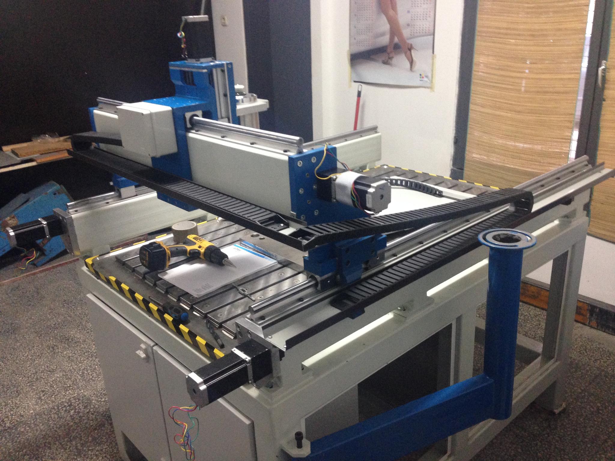

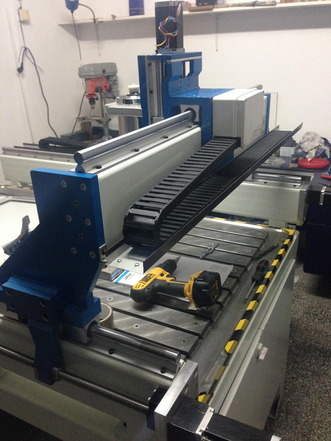

  7. #57
    Long time no update. Here are few new pictures of my build.
ID:	17369Click image for larger version.
ID:	17370Click image for larger version.

  9. #59
    Nice work digisoft, should work well
    Any photos of the 'front' of the machine showing the spindle / Z axis?
  10. #60
    Yep, I'll make new photos today with better camera.
