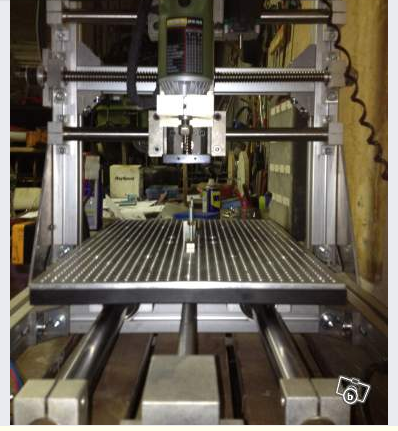

    Hi all,
    I am relatively new to DIY CNC machines. I have been looking for one pre-essembled so I can load my PC with software and start learning how to use it all. I want to mill and engrave aluminum as well as carbon fiber sheet, plastics and hard wood. Just as a hobby and to make things for my workshop at home.
    I do not want to spend a fortune. I have found one for sale, here in France. Please could you take a look at it and advise me what it might or might not me capable of ?.
    I have used Google translate to get the description into English the best I could.
    - Course X: 470mm (560mm with less possibility of rigidity)
    - Travel Y: 300mm
    - Travel Z: 150mm
    Engine Transmission Thread: toothed belt on 3 axes
    Transmission ballscrew on 3 axes:
    - Y: Steinmeyer 20mm (High Quality)
    - Z: Trolley mounted on THK rail, screws 16mm (High Quality)
    - X: ball screw 16mm (Brand unknown)
    runners:
    - X and Y: Rails cylindrical hardened steel and chrome plated 25mm
    - Z: prismatic Rail
    Spindle :
    - Proxxon BFW 40 / E control module with 250W
    - 900 to 6000 rev / min
    - Bearing robust planned for machining aluminum
    Electronics:
    - Map mechatronics 4 axes ( 1/8 1/4 1/2 and 1) with many inputs and outputs for accessories.
    - 4 probotix Motors NEMA 23 400 oz / in
    (1 additional engine for a 4th axis)
    Milling with sensors limit of Y and Z
    Maximum forward speed: 1400mm/min
    Accuracy: 0.005 mm
    aluminum vacuum table (can be changed)
    Comes with:
    - Lots of strawberries
    - Case control
    - Connectors
    - 1 Motor NEMA 23 additional
    - House of protection
    Machine ready
    Milling machine operated under Mach3 but can very well with other software.
    Hours of Operation:
    I give up to 5 hours of operation
    The machining was the longest 50 minutes
    The total price of the machine parts came easily to 2000 Euros (Borderless or labor).

  2. hi and welcome.
    the main limitation with that machine are the unsupported rails and the low power of the spindle motor. its ability to machine aluminium will be severely limited as its not rigid enough to do anything more than very light cuts, think engraving rather than machining. also, while the resolution might be .005mm the accuracy wll be nowhere near that. its good enough for making pcbs or engraving plastic coated aluminium panels or cutting balsa or softwood or plastic parts for model aircraft or doing simple signwork in mdf as examples

    it's probably worth it for the strawberries! sorry, couldn't help it...looks like Google Translate (which is a godsend) failed on that one .......dudz, strawberries are a fruit :-) so you're saying that the CNC machine comes with a lot of fruit :-)
    That machine you've posted photos of looks reasonable to my (non-expert) eyes! I'm not sure I'd pay 2,000 euros (especially since its used)....I have that same spindle & whilst it's a nice quiet, quality spindle, it's rather heavy (so may challenge your Z motor to get fast rapid movement), somewhat underpowered & the 8,000 max rpm will severely limit your cutting speeds

  6. Depends on your definition of good results. With the lack of rigidity the finish could suffer and with that spindle you'll be limited to small cutting tools so removing any significant material is going to take a long time. Its going to need dozens of passes rather than two or three. Its hard to be definitive but I think you'll find it limiting for anything but the smallest of jobs.
    Personally if I was buying secondhand I'd want to see it cutting and do some trials first...

    Probably best to discover the wonders of supported linear rails, and profile rails. Rigidity is key for these machines to be fit for any decent purpose.

  10. Dudz,
    The French machine can be improved upon from where it is at (adding a back plate to the gantry to improve rigidity and when able going over to supported rails (or profile if able) for the Table. A Kress 1050 FME is able to cut Ali' and I get rather good finish with it. It really depends on what you want finish product wise and what are you are willing to accept cutting time wise.
    Good luck and keep asking questions even when you don't like the answers take them on board and chew on them a bit. Most the folks here really do want folks to do well.
