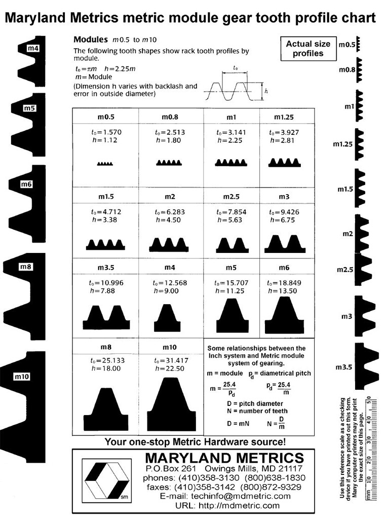

    Having just looked at the actual size diagrams in my HPC gears catalogue, I'd probably pick something in the 2-3MOD range.
    The smaller you go, the more noticeable any contamination will be, and the larger you go, the more the non-linear motion from straight cut spur gears become.

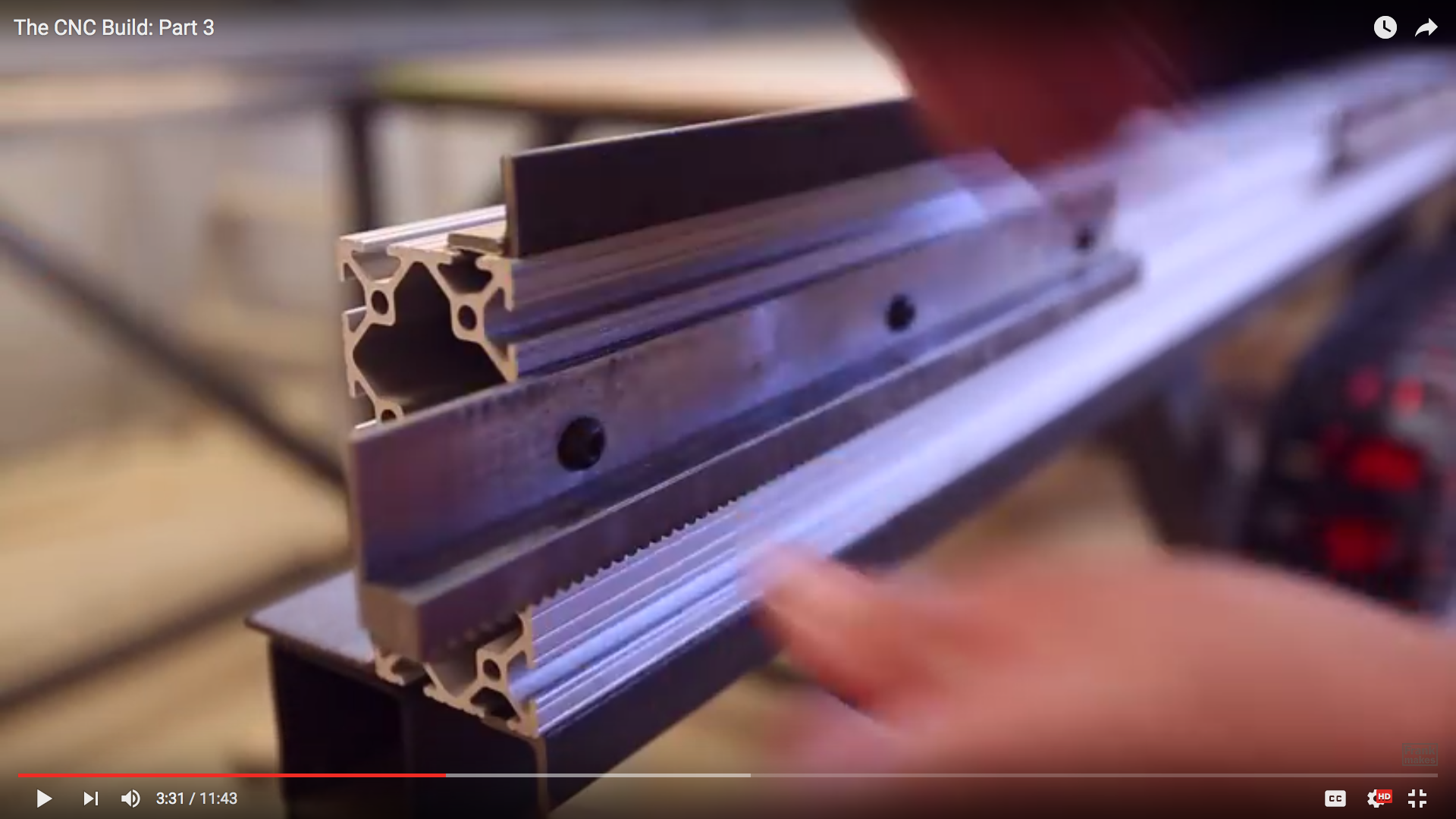

    Having recently designed a machine with rack and pinion, where the requirement was speed as opposed to smooth running/accuracy, I would suggest you go with the smallest economical one you can. Nonlinearity will be a real concern with anything larger than 2.
    To avoid contamination, mount the rack, with the teeth pointing down
    For a visual comparison:

    I'm planing a R&P router myself and would like to ask two things?? What do you mean by contamination? And, When you say mount the rack, do you mean something like this?
Name:	Screen Shot 2016-06-03 at 15.34.49.png
    Sorry if the image is small.
