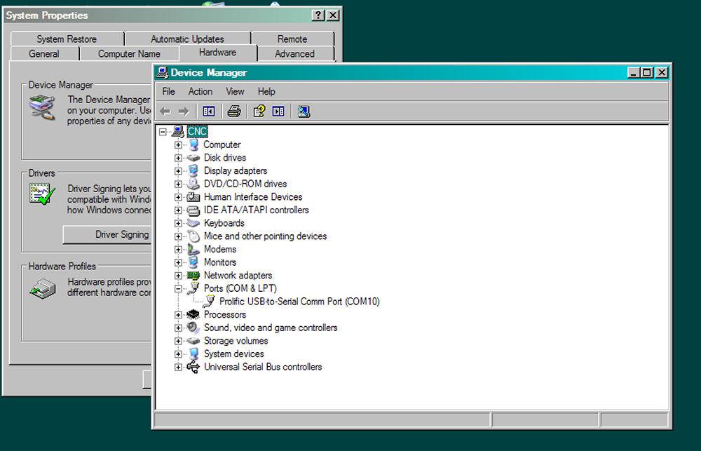

    This is my cable, it's a USB to serial converter then a short length of cable cut from an old phone with the correct plug already fitted.
    I used default settings for everything else.
    Pinout details for cable http://www.leadshine.com/UploadFile/...munication.pdf
    If you plug it all in then on your PC go to, Settings - System - Device Manager, you will see if it's connected and which COM port number it has. In my case it's showing the USB to serial converter on COM10

    Eddy, I've been playing with Protune on my XP machine today. I kept getting the error that you show. After a bit of research it turns out that it is due to the file stored in RAM on the drive being generated in a different language (probably from a Chinese machine).
    If you go to Control Panel - Regional and Language Options then click the Languages tab and tick 'Install files for East Asian Languages', once it is applied you won't get the error message anymore.

    I'm almost certain it's not going to be COM1, did you look at the ports in device manager ? while you are on that page, keep plugging/unplugging your interface cable a few times so you can identify which component is changing then you can see which COM port it's using.
