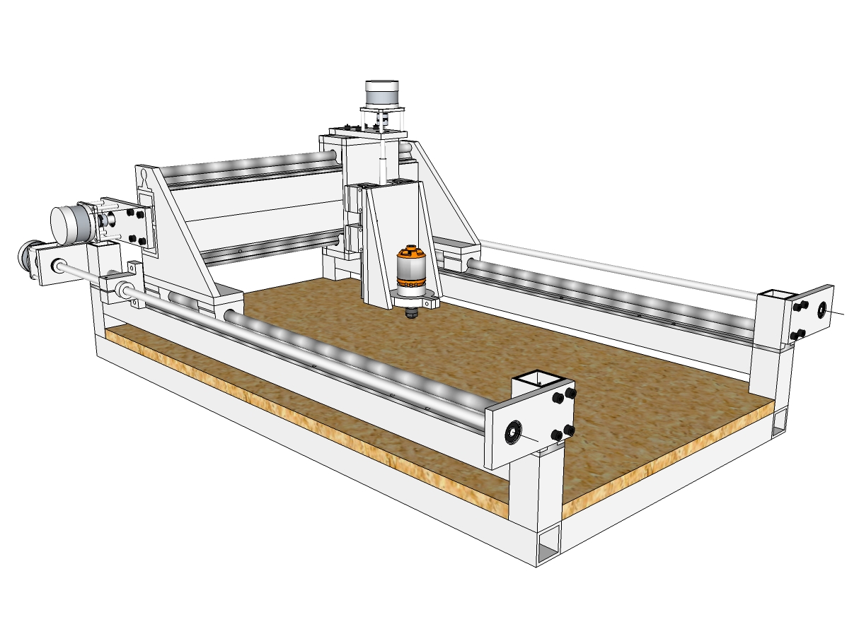

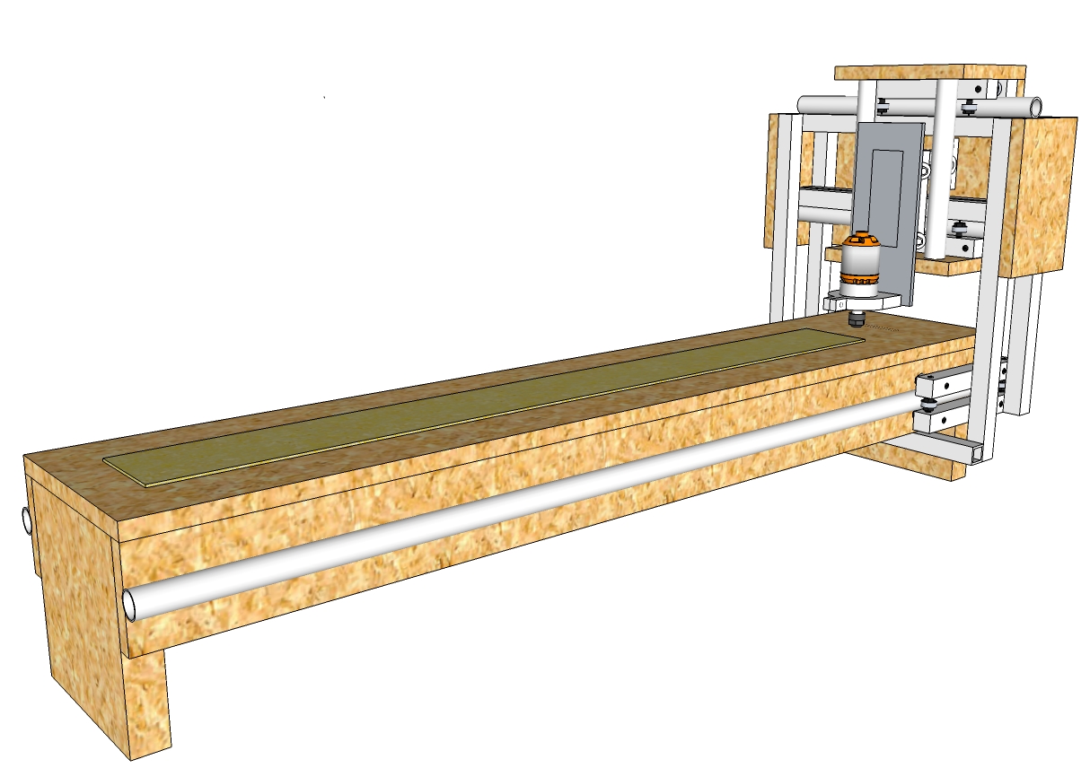

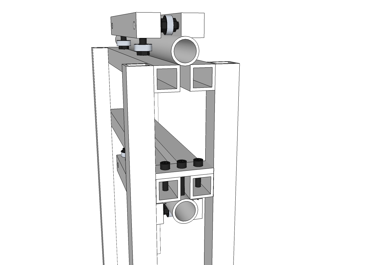

    This is driving me crazy now. I have 5m of 3/4" aluminum angle already but I keep swaying towards using pipes as rails. I have all the bearings too.
    My ideas are below. Do I mount the angle on the side of the torsion box as indicated or use pipe? Do I mount the pipe on the top use angle?
    This machine will have a total size of 27" x 20" (700mm x 500mm) and is made from 3/4" MDF. Height of the torsion box (including top and bottom skins) is about 5 1/2" (136mm)
    It will be used for engraving and cutting acrylic and mdf up to a maximum depth of 10mm.
    P.s. I can't afford proper rails or 8020 at the moment. My budget is really small so I can't be throwing money around.
    Please somebody save me from insanity.

    Think i'd go with the design on the left, but using the angle rather then the pipe.
    If the design on the left is to scale then there dosnt look to be much mdf left after sinking the pipe.

    I already have a couple of reservations from what you have said, not sure that 3/4 ally angle is wide enough for use with skate bearings ( I assume that's what your using) secondly what gauge is it as 1/16 won't be suitable.

    Is the angle still going to be too thin at 1/8", because if it is then I'm definitely going for 1" steel pipe instead.
    Neal, in the Build your own CNC book they use 1/8" all angle so thickness is OK but I am not sure 3/4" is wide enough to mount the bearings on. The book uses 1" or 1 !/4" ally.

    The best advice (as given by Jonathan, Jazz et all etc.etc.) will be to use supported rail and all the good things that you can't afford as you'll only be dissapointed by the machine's performance and will end up spending the money anyway on a second build....but.....if you've got a design in mind then I'd say stick to it as long as you're happy with the fact that there will be limitations to the machines abilities. There are 1000's of people out there with MDF machines who are very happy with their machine.
    I've gone for 3/4" NB red band pipe which will be drilled and tapped and bolted to the MDF sides (sort of supported rails :) ), there are cross braces under the 18mm skins of the base (torsion box) to further strengthen it. The Z axis will sit on the same pipe (377mm wide) which will again be bolted to some 1" 10 gauge Ali box etc. etc....you get the point, see below.
