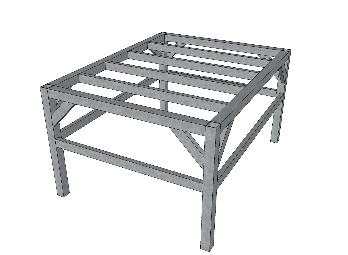

    You shouldn't underestimate the importance of rigidity This isn't just a case of using strong materials, but bracing too. There is no point making a strong gantry if the bed is plywood for example; if the work moves (bed resonates) it is as bad as the cutting head wobbling about. Making a machine to cut wood and plastics is one thing, making it cut aluminium is another so if you don't really need it to cut metal you can save money and design/build time.
  4. #14
    Here you go....this is the sort of base frame you should be creating. It's only a quickly knocked up example but has a 50x50x3 box section outer frame, 50x25x3 bed supports and bracing.

    Hi Guys, just going to adjust my design again, I have been told to use belts earlier in this thread. Where would the belts go and what is the advantage of using them. Also what would it attached to?? does it attach directly to the stepper motors?
    Is there anything else I need to know?? or have missed out from the diagram such as a vital component??
    Also is it difficult to do the electronics and the wiring?
    Thanx again :-)
  8. #17
    You can do either of 2 things...one is to use a stepper on each X axis ballscrew the other is using pulleys and belts. running both ballscrews from one stepper. On the belt one you put a pulley on the end of each ballscrew and one on the stepper and connect them with a belt. Most people seem to use 5mm pitch HTC belts...

    Belts and pulleys connect the stepper motor to the ballscrew. Some of the advantages are the ability to select the drive ratio, so you can make the motor operate in the optimal region of its speed/torque curve and they help damp vibrations.
