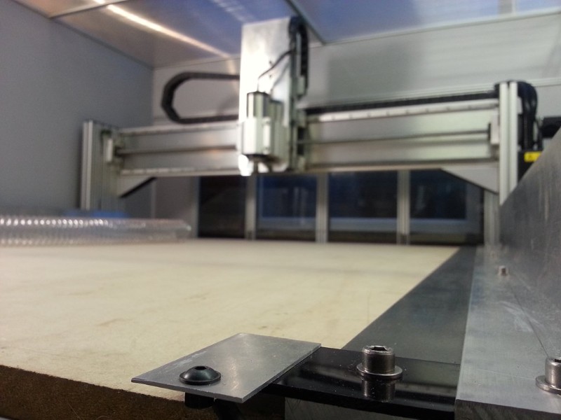

    Stiffening up the Y axis rails. 25mm Alu plate bolted into the extruded alu that the hiwin profile rails mount into. Also some 100x50x6mm L section to help keep the rubbish off the rails. Loads more rigidity after this.
Name:	Bed Reinforce2.jpg
    Its got a decently braced bed on there now. The original was pathetic.
Name:	Bed reinforce1.jpg

    Inductive proximity home/limit switches including dual ones to auto square the gantry each time you home.

    Nice work guys the machine looks really good, you can see the care and attention that has now gone into it and it really looks 100x better.
    Cant wait to see the first cuts!
    .Me
    .Me
  9. #19
    Now thats what it should have been like right at the start. Well done, very nice machine.
