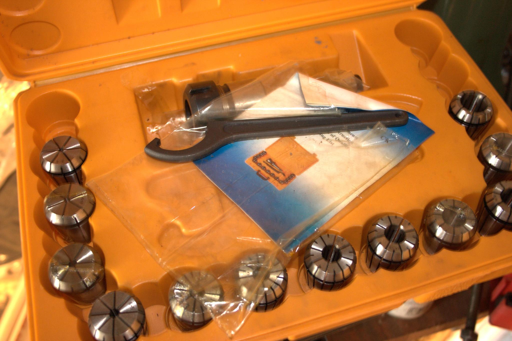

    Hey, one would need an easy way out, from a few questions. Please help if you can:
    1) What I have is this set of collets (actual picture)
    1.1) On the collet chuck there is a text ER32 - MS3
    - think the set is similar to this:

    Anything with a straight shank upto 20mm diameter will fit into an ER32 collet, provided you have the right collet.
    Each collet covers 1mm, and the size is usually etched into the surface that points up when in the box.
    Great information - thanks! I will look from straight shank fly cutters :D
