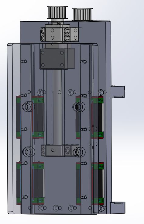

    Thanks for all the feedback guys. I think I'll go with Hiwin 20mm for the Z axis. What would be the "minimum" recommended centre distance between the two rails? I want to keep this as small as possible to maximise the effective Y axis length but without compromising rigidity. At the moment my whole Z axis assembly is 130mm wide..

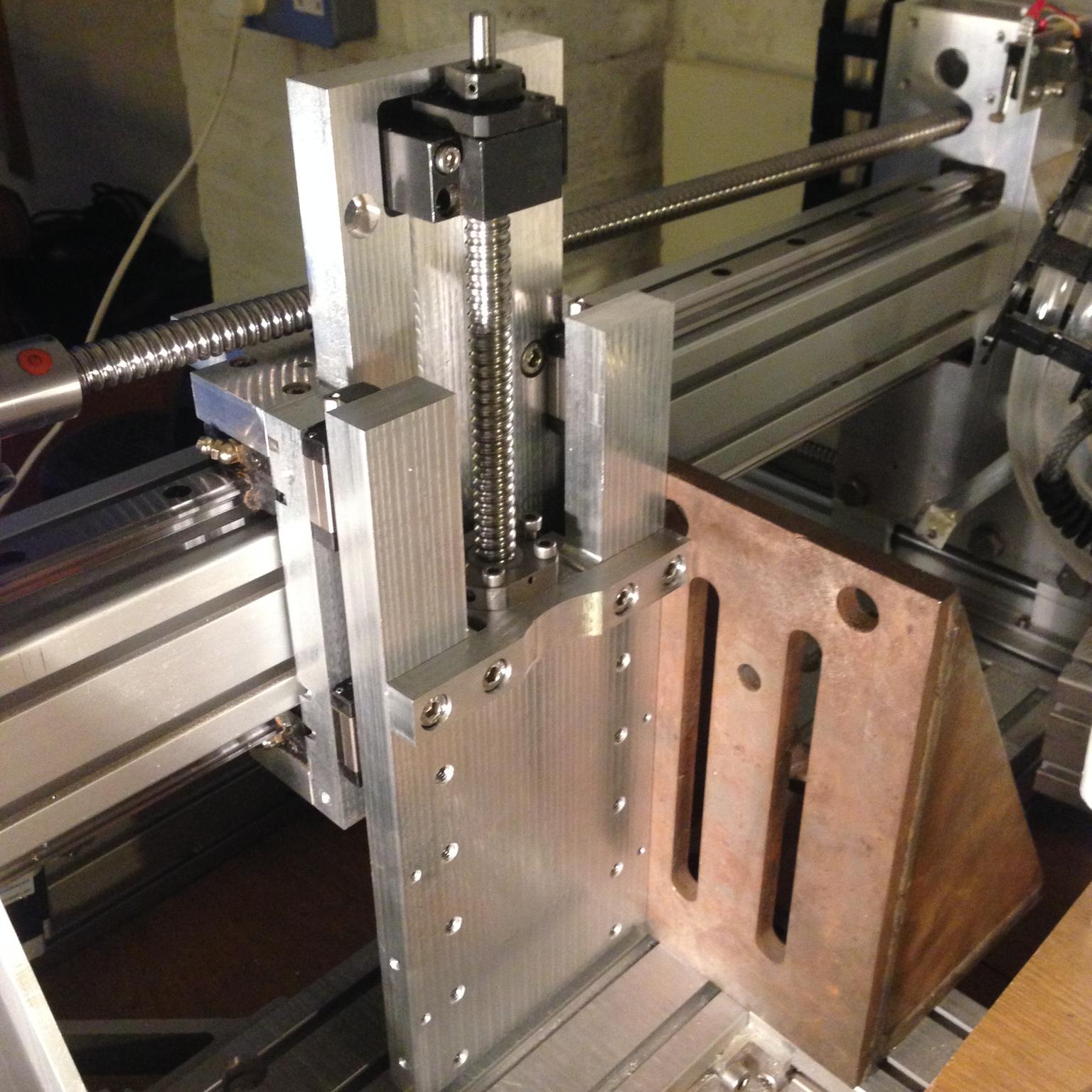

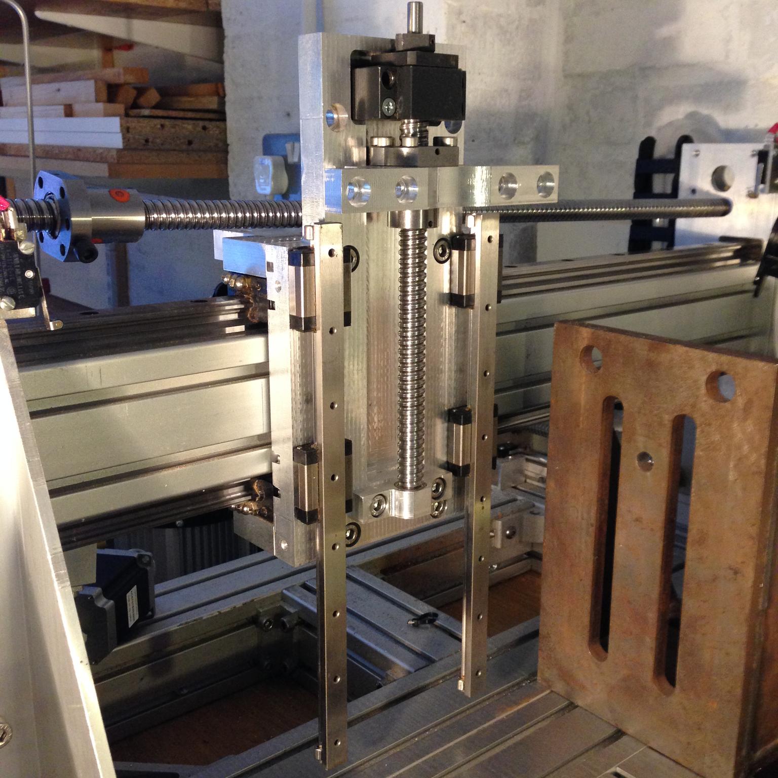

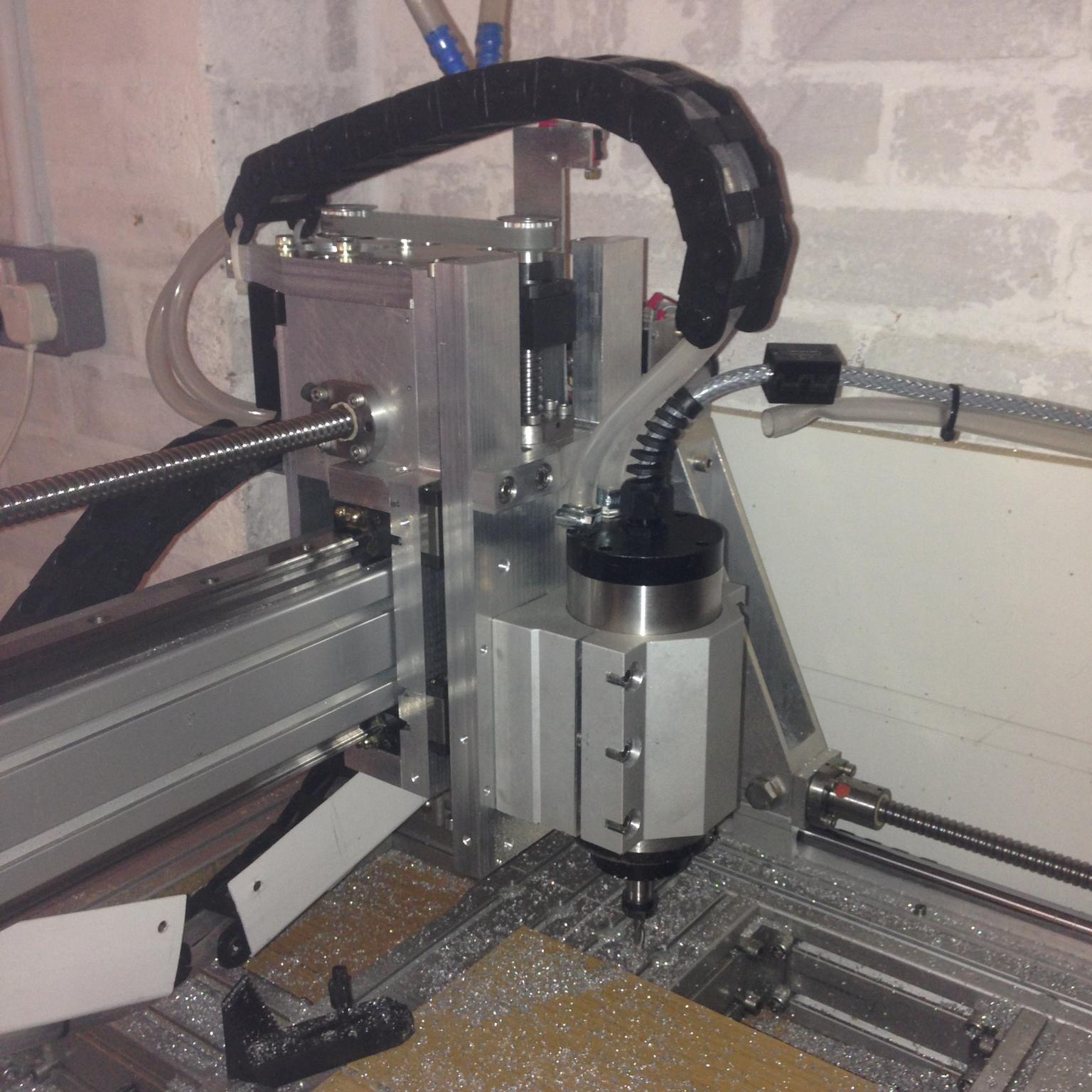

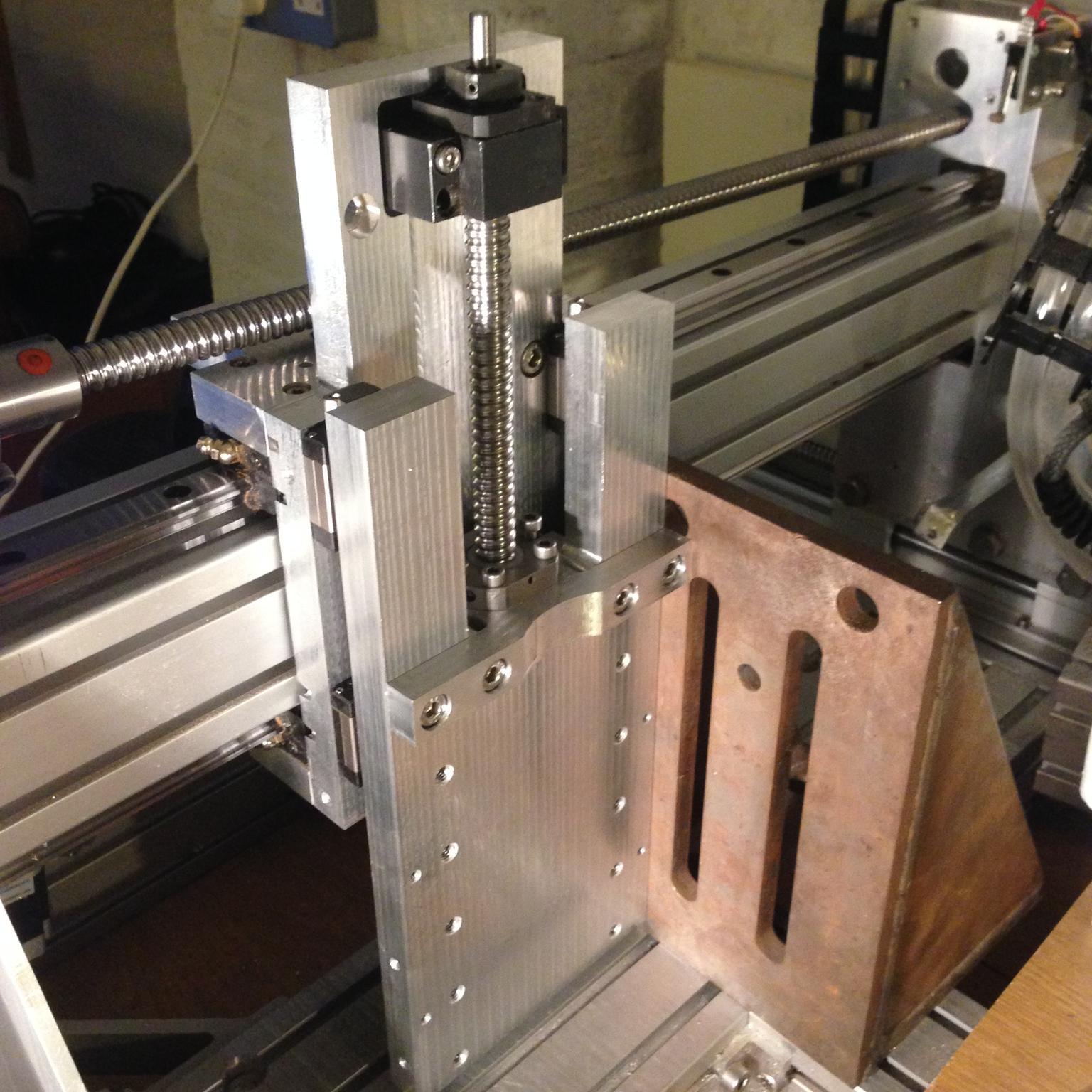

    My Z axis plate is 147mm wide and the Z rail centres are only 115mm apart. I did this to maximise Y travel and placed my Y axis bearings pretty much back-to-back.
    This works fine for me, but it can give you more stability and less likely to rack if the Y bearings are spread further apart, but you are trading Y travel. If you do spread the Y axis bearings out further, closer to Lee's figure, then I don't think you need to follow suit with the Z rails and can keep them fairly compact.

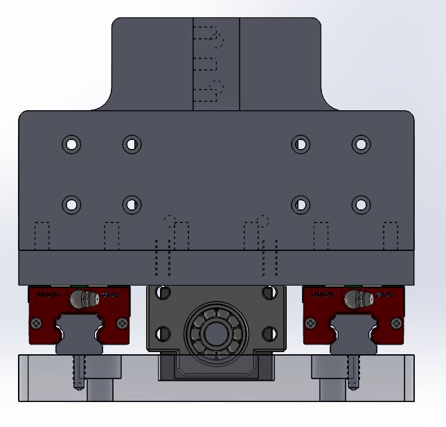

  10. #150
    Your machine looks great, thanks for all the advice.
    I've increased the plate width to 170mm now. The z rail centres are 118mm apart at the moment. Do you think the carriages need to be separated more in the z axis? (They are 119mm centres) I'm trying to reduce this length as much as possible in order to reduce the total height of the z axis plate (if that makes sense.
    Also, is it worthwhile pocketing the carriages slightly like I've done elsewhere?
