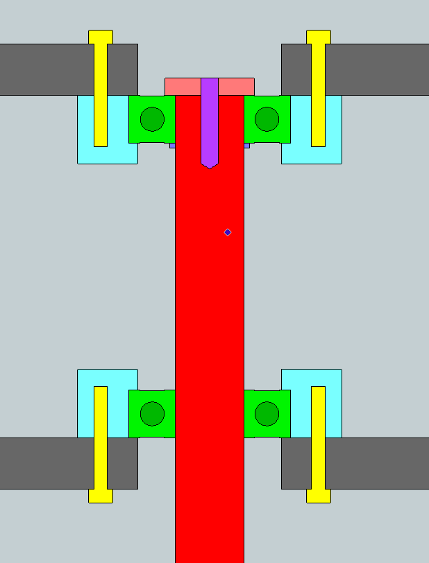

    There are various ways it could be done.
    Proper way would be to shim, but can be problematic getting shims the correct size/thickness.
    You say the end one will be held on via bolt. Could you use this bolt to adjust the preload? A bit suitable loctite will stop it from slackening (you could add lock wire or a locking tab for extra security)

    Ideally yes, but you're not running them in an ideal application.
    To set this up how you want, you'll need to use a DTI (Dial Gauge) set-up to measure the end float, then you would gradually tighten the bolt until no end float is measureable.
    Would it not be simpler to use double row angular contact bearings as mark mentioned?
    That way the preload is preset, however it does mean you need someway to secure the outer into a housing.
    Taper roller bearing preload depends on lots of factors. Are they mounted facing or back to back, what part is likely to warm up/expand the most, is expansion an issue, how fast are they turning, what's lubricating them...
    What exactly is the application?
    (feel free to PM if you don't want to say publically)

    Well to start with this is all vertical, so anything hanging off the ball bearings will be adding to the overall axial load. In normal running conditions the axial load is low, so I had a 'bright idea' moment today and came up with this:
    ie. single circlip and a bolt from the top which attaches the shaft to the top bearing, the low one is simply for support and to add more stiffness. Great right? wrong. I think the shaft hanging off a single ball bearing (shaft is SS, weighs a few kg), the additional axial load from running the thing and simply any play in the bearing will most certainly not give me zero axial play.
    I like the idea of preloading, as it fixes some problems, but looking at the above you can see that adding two lock nuts to the top will be problematic as well. Normally a preload is applied by tightening one lock nut and locking two nuts against each other. I will have no access from the sides so that operation will be tricky or at least no-so-hassle free. Second thing is that tapper roller bearings need to be lubricated (me thinks) and I'd much rather have a sealed unit which simply runs without touching it.
    DTI is not an issue, heck I have a prototype with tapper roller bearings which has zero axial play, but I'd rather avoid the problems described above (the prototype doesn't have a whole in the upper horizontal plate and so is easy to preload with lock nuts, although the bearings are exposed). Angular contact bearings might be the answer, but single rows will need preloading (ie. lock nut issue) and double rows will not work that great as I need bearing support 100mm apart.
