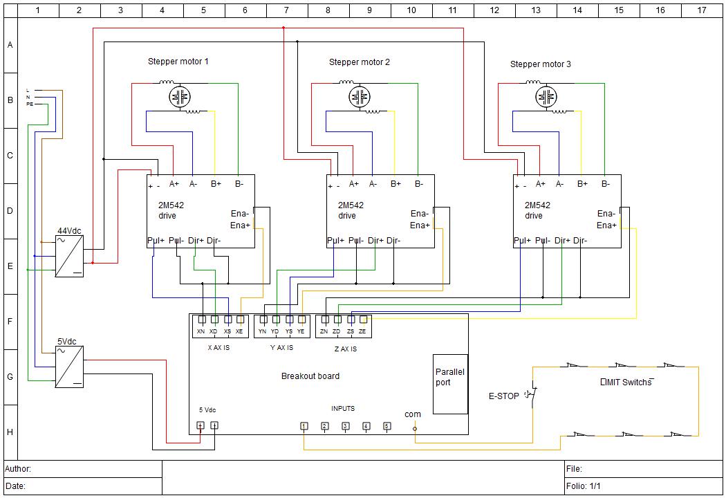

    Ok so my understanding so far apart from how to connect the motors to the drivers to the breakout boards is attached. please let me know how to add to it.Click image for larger version.

    Quote Originally Posted by scnc View Post
    Here you go try this.
    The motor wire colours probably won't be correct and you'll need to test the wires to find the phases. Also it doesn't show fuses etc and you'll need to add some but should give you an idea of what wire goes where.!!
