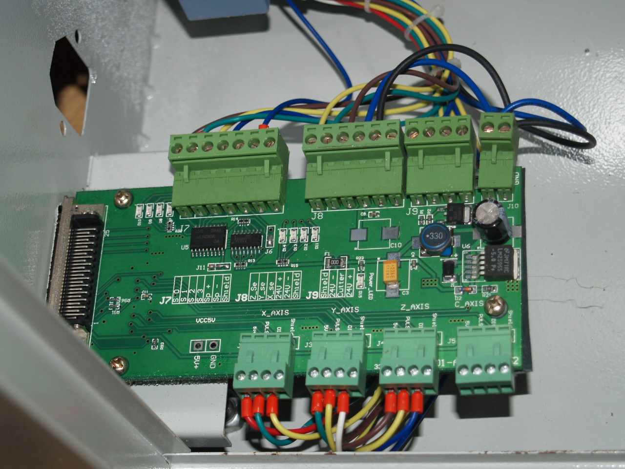

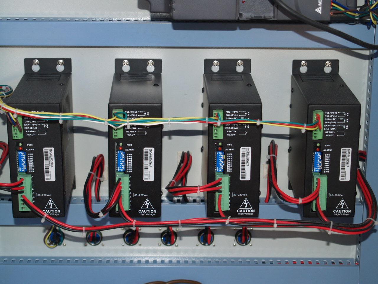

	04-02-2013 #18You have 4 axis so use the C axis for the slaved drive. Honestly wouldn't use 1 output for 2 drives if you have a spare output which you do.!!
 Yes this is common setup and you can control all drives/motors, just need mach setting up correctly and it will be fine.
