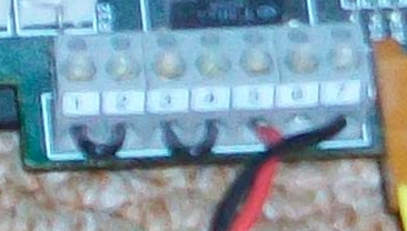

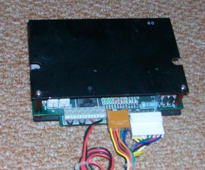

    I bought 3 dc servo drivers off eBay and cannot really find any information on the case to get any further detailed information :(
    I have the matching motors for the drives which are wired into blocks which slot in so they are no problem.
    This leaves 7 terminal screw blocks.. I've done a test using an old atx psu powering it up using 12v and the motors ran. The supply was connected to terminals 5 and 7 so I assume that 6 is for a ground. Terminals 1,2 and 3,4 are respectively shorted with bits of wire.
    so can anyone help me figure out what 1,2 and 3,4 are and how I may control it?

    These are a couple pics of the drives in-case my description was a little off

    Silly thought, don't suppose it has an encoder? G.
    Hi G,
    I do believe the motors have encoders attached, I can add pictures of the motors tonight If it helps!
    Cheers,
    Sam
    Might be worth removing the cover from one of the drivers and having a look to see if there is any lettering on the circuit board which might give a clue.
    Hi Sam, I only mentioned the encoder in case that was the answer to the extra wires! G.

    the encoder is connected using a push in connection. I can only guess that 1,2 and 3,4 can somehow be used to control the motion. I guess that when one set is not shorted the motor will run in reverse leaving the other one as a step input? I will update the thread later when I've tried!

    Hi all,
    I've had another tinker and these combinations will start the motor spinning (always same direction):
    Pins shorted:
    1 , 4
    1 , 2 and 3 , 4
    I have a multimeter If there are any readings that may help work out the pin configuration.
