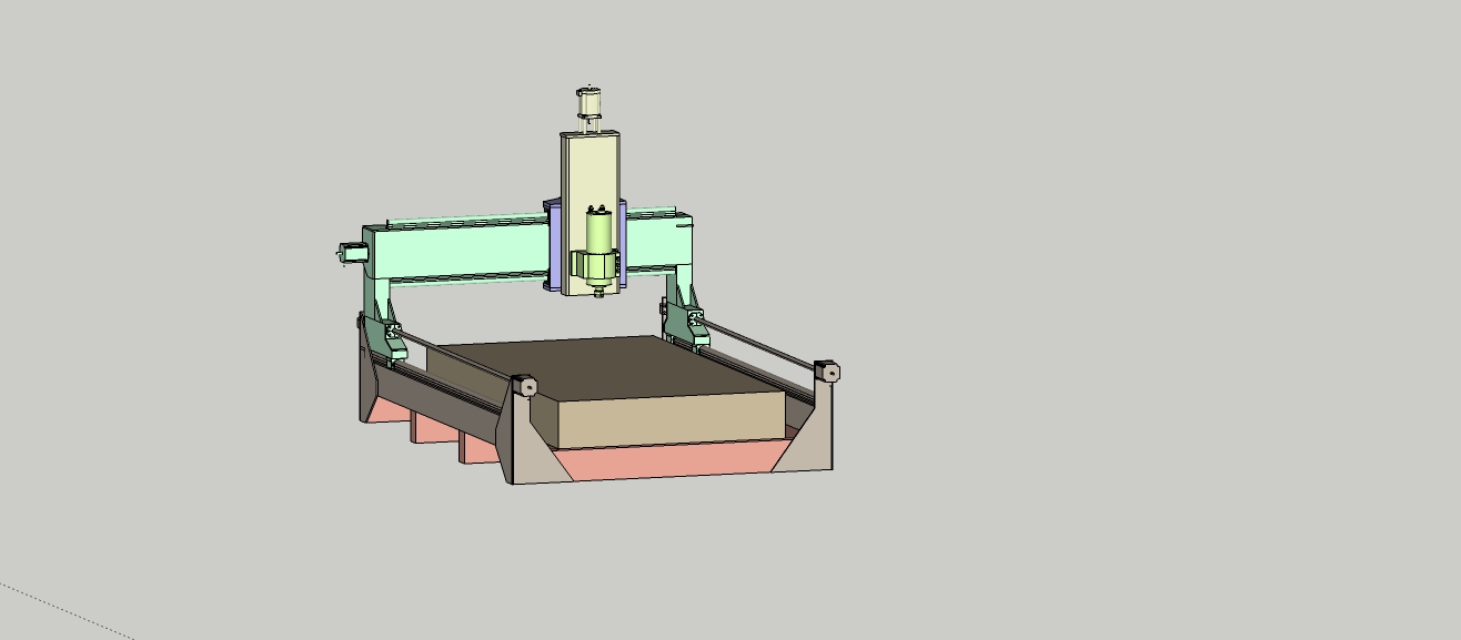

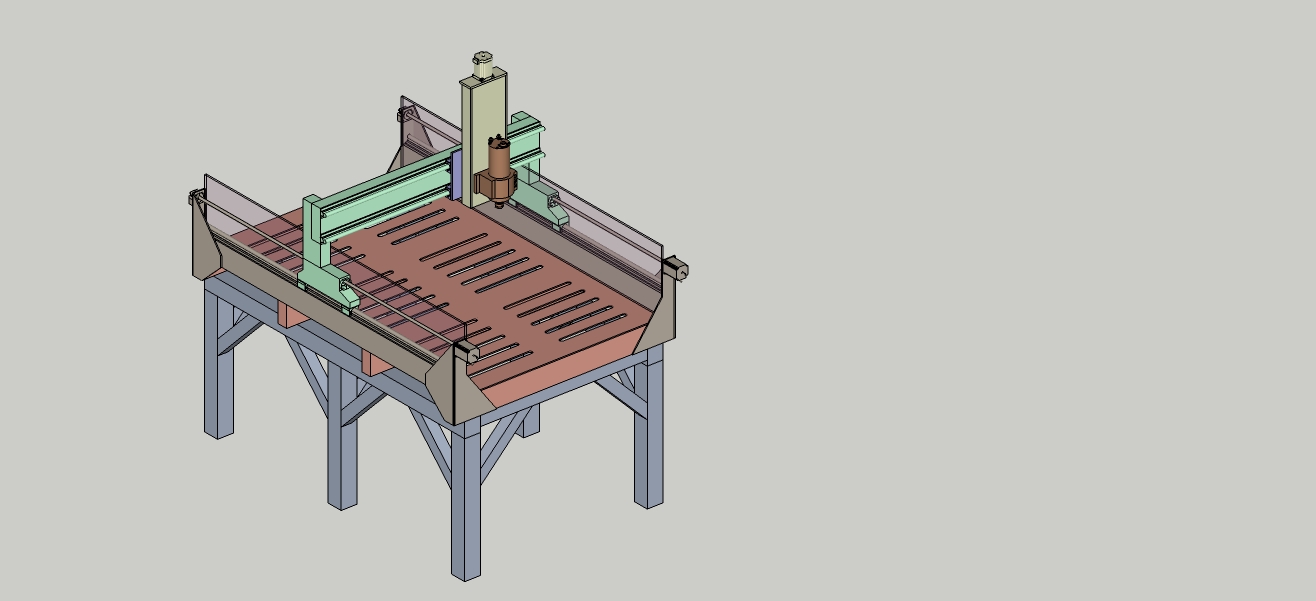

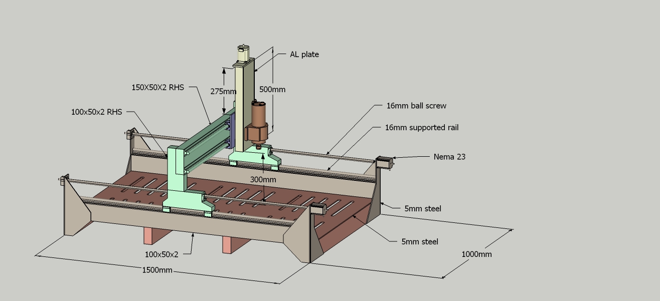

    anyways heres a drawing ive been playing with today.....Click image for larger version.

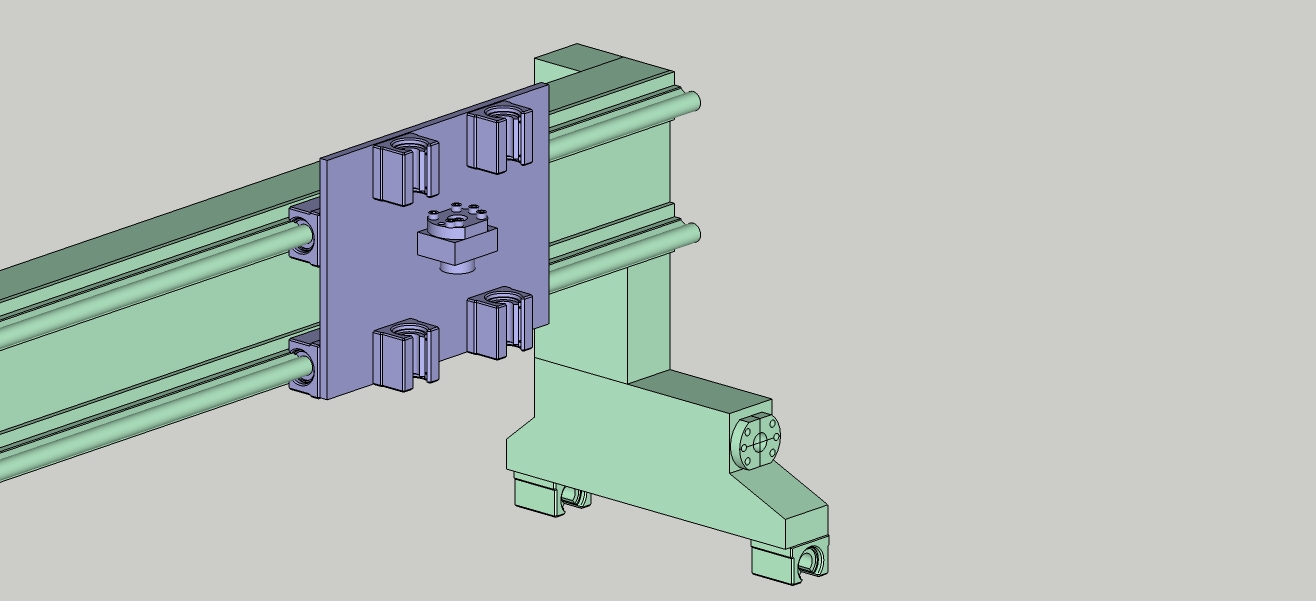

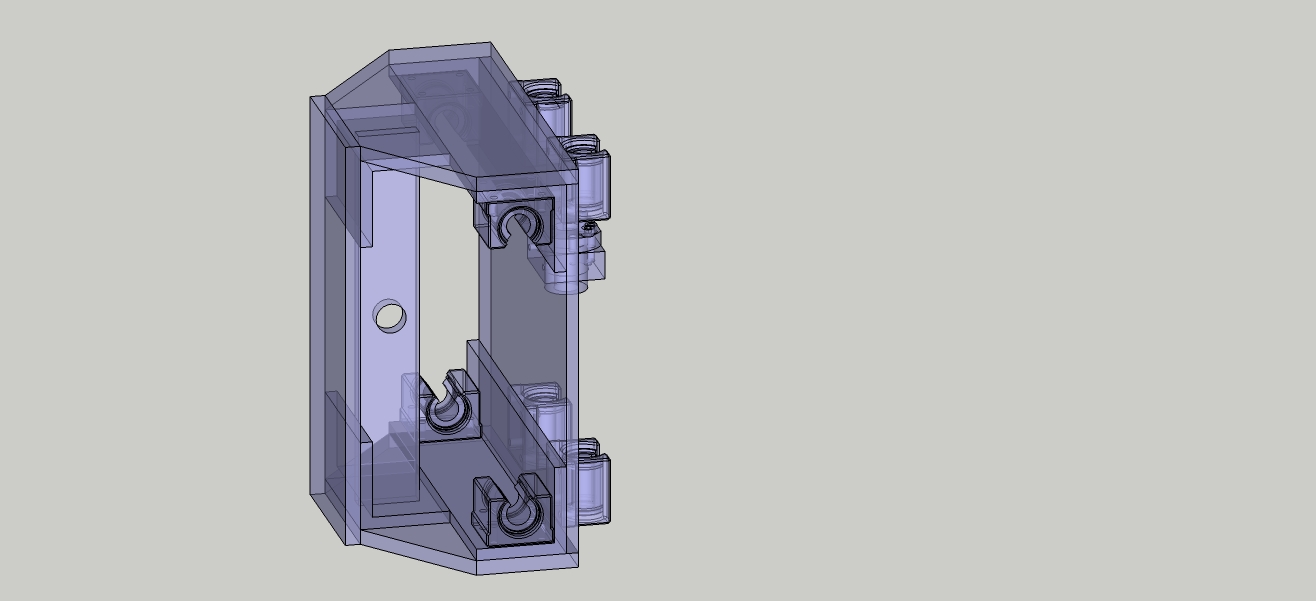

    photos are a bit all over the shop , this is the most recent version- Click image for larger version.
Name:	bracket on gantry.jpg
ID:	16606most of the steel, like deck and y rails and gantry sides was to be 100x50mm steel maybe 2 or 3mm thick, with the gantry maybe 150x50. The X carriage is envisaged as a aluminium plate perhaps 10mm thick with lots of bearings either side, z bit aluminium plate made into a bit of a box. was hoping to get 250mm travel on Z. Gantry is 300mm above bed/ deck/base. Might be pushing it a bit with Z.
    With the base i was thinking of 5mm steel plate. there is also steel plate in corners of and holding ball screw ends/ motors.
    im a bit concerned with having this type of supported rail as i have read some bad things about the here, also probably not the best having them on their side as per my x axis ?
    cheers ben

    Welcome to the forum Ben what do you intend to cut with this machine also it might be a good idea for you to read through some of the build logs on here.

    Hi, welcome to the forum! I'f you're thinking of mostly machining wood then I'm guessing that 95% of the time you'll be cutting at full extension. This is going to create one hell of a lever with your current design of gantry and Z axis. I'd be inclined to think about making the gantry shorter and having some sort of adjustable table so that when you do want to cut thick materials (probably the 5% of the tine it's used) you can lower it.
    Neil...

    hi Neil, Yeah the z has me worried. Like you say i was thinking of making a box for building up height if cutting sheet product,
    Just wanted the option to cut thicker stuff, but i supposed there is a limitation in depth of cut due to length of router bit ?
    With the deep table i was thinking i could leave options for future 4th axis to turn timber,
    (Also perhaps a water bath if machine could cut some steel plate attaching plasma )
    all dreaming, just priced 16 mm screws and rails at over $800au$ (not including 1 1500mm Y ballscrew)
    maybe i should price up vslot extruded aluminium option.....
    cheers

    I cut mostly sheet stuff and if I had to put a box there it would be a PITA. Plus you'd have to make the bix so strong that it would be like a second bed anyway to stop vibrations....

    good point about vibrations Neil
    Think i might shorten travel by 75-100
    as for hardware, bit out of my budget at the moment- maybe i should build intermediate machine that reuses stuff i have.....
    have a good one, cheers

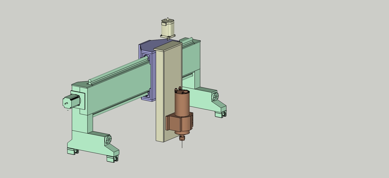

    stiffened x carriageClick image for larger version.
Name:	ben x carr detail.jpg
ID:	16624Click image for larger version.
Name:	ben x carriage.jpg
ID:	16625Click image for larger version.
Name:	ben new x carriage.jpg
ID:	16626 connection to gantry by having rails top and bottom

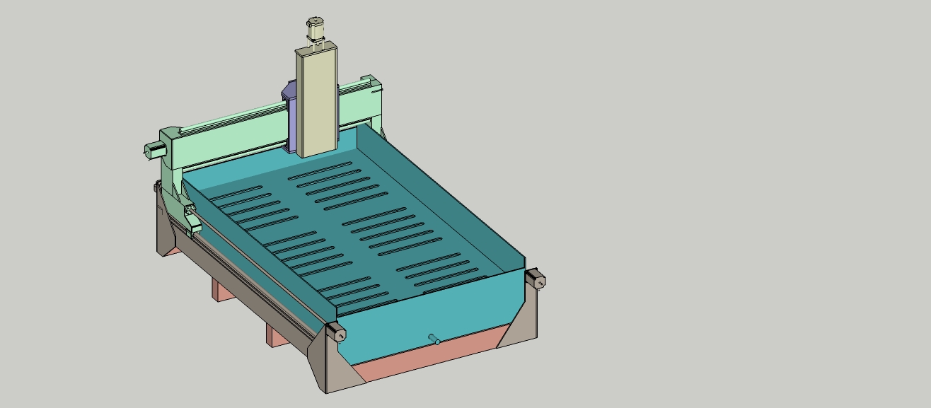

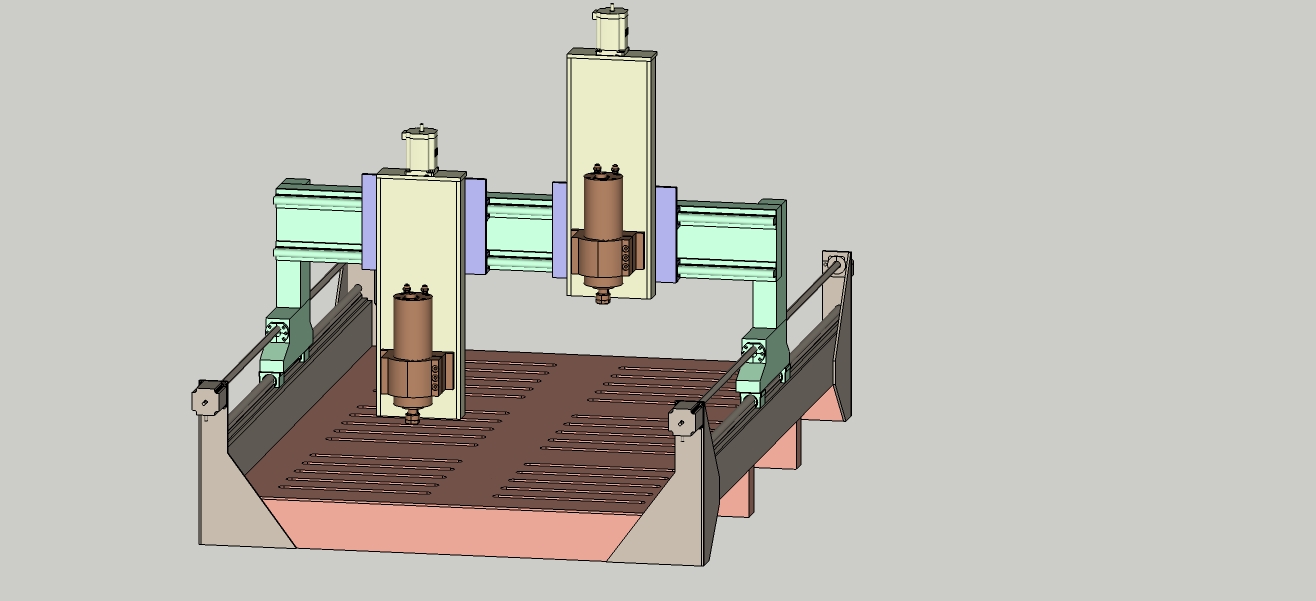

    reasons for wanting high z - adaptable for possible plasma bath, box to cut thin stuff, 4th rotating axisClick image for larger version.
