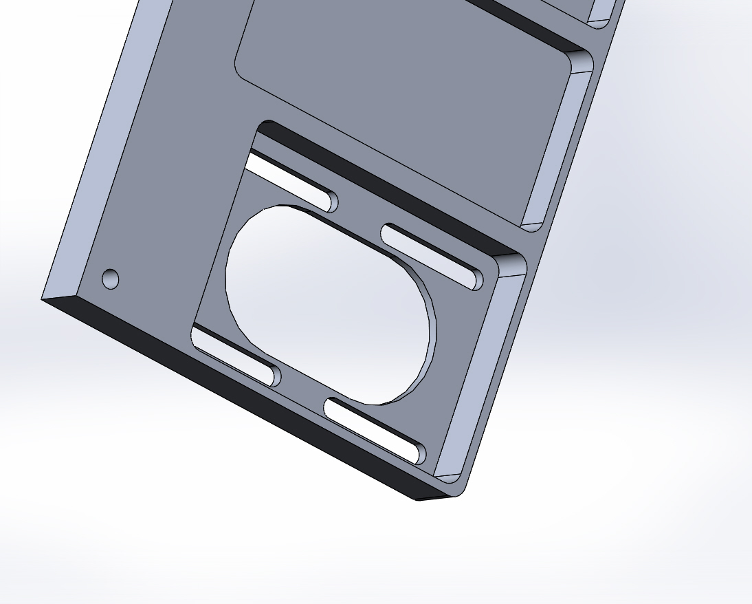

    Thanks, Clive, and you have reminded me that I need to allow for the flanges on the pulleys so a bit more adjustment needed than I was thinking - but 40-50mm seems fairly generous? I was thinking of more like +-5mm?
    The longer slots are to be able to change pulley size if needed and also so than it will fit a small range of belts sizes.Click image for larger version.
    I don't allow for any adjustment. That's the wonder of CNC, you cut it right and everything fits
