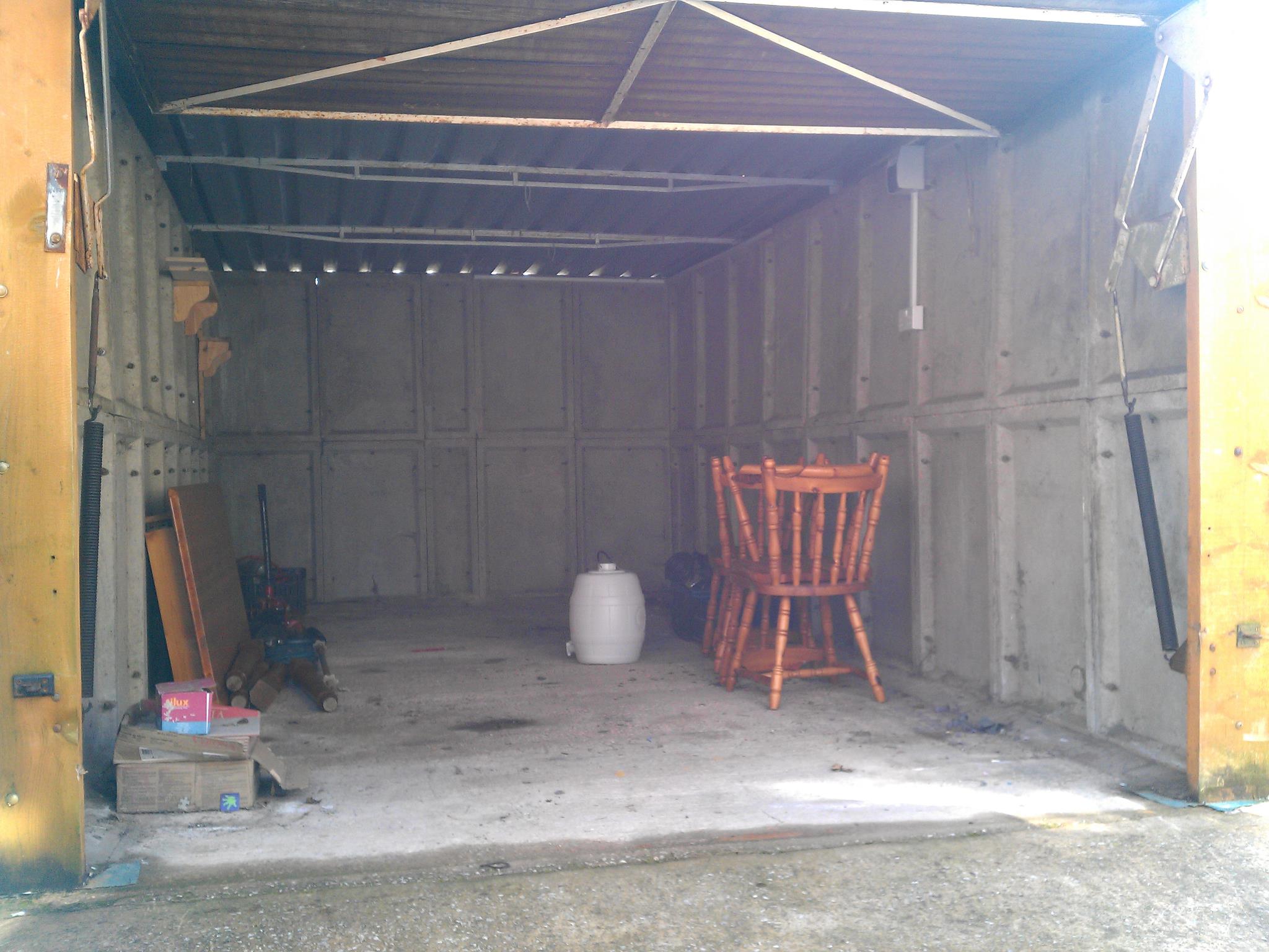

    started off like this

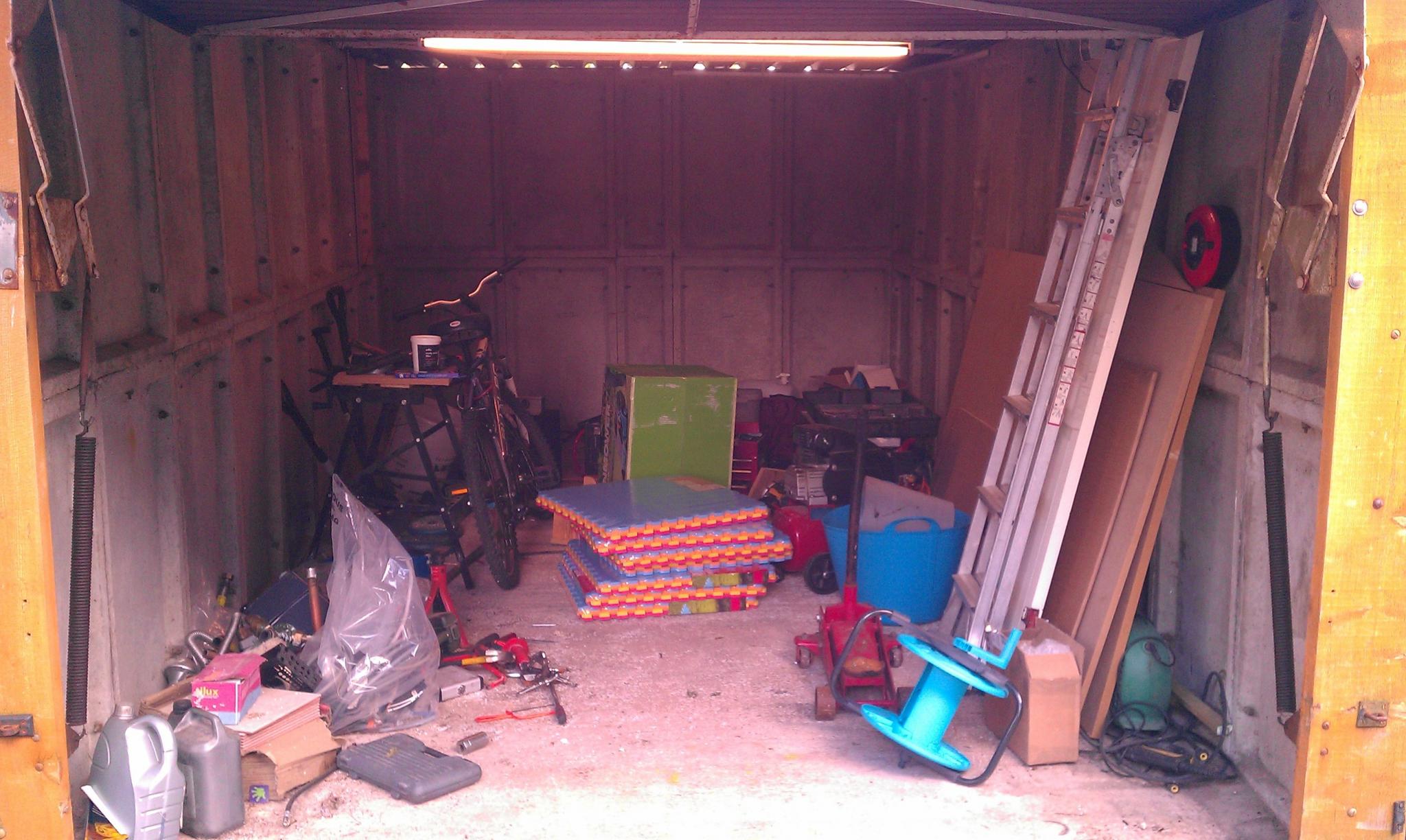

    as a storage place while we moved, believe me the amount of crap I've shifted out of that garage the last few weeks has been depressing

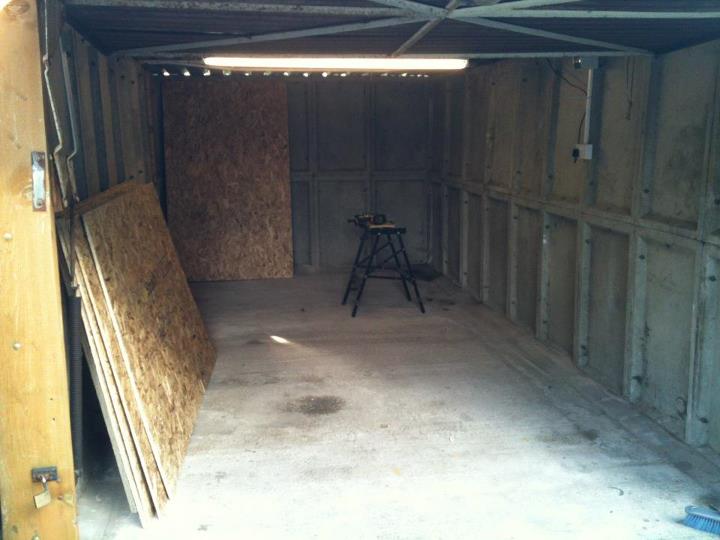

    so today i got started on cladding it out, material of choice is BnQ's OSB 2 11mm board, all cut to size and delivered to the garage all i have to do is simply drill a few holes and it's done

    all cleaned out ready to clad
    I've had problems drilling the concrete garage as i believe it's steel reinforced so it's pot luck if i hit any metal.. i hit something today i'm it melted the bit square off, so i'm borrowing an SDS this week which will hopefully help get it done

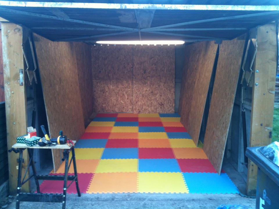

    the funky flooring is actually some cheapo outdoor play mats that Tesco were floggin off for £3.50 per pack of 4, i'd always said i wanted a padded floor due to bad knees so i'll never have to worry about where i'm kneeling down, plus i plan to do some exercise in here as well so it's multi purpose it also has the added benefit of being soft on the feet so when standing still for ages it wont be a cold concrete floor beneath me. i actually like the fact it's coloured :D
    future plans are 2 x 25mm mdf worktops which to start with will be mounted on some timber frames, but i would like to make steel box section frames and bolt them down to the floor so i can mount a vice on one and have better stability. at the end of one work top will be the mig welder I've just bought, the end of the other one will be a table saw. the cnc i plan to build will basically take up the space of a 2x2 square of the flooring.
    i also plan to have a weights bench in there as well, i may even make provisions to have this folding out the way so it doesn't take up too much room and a rack to hold my homebrew kegs, one of which is pictured in the first picture

  2. Nice garage. Be very careful about drilling into the reinforcing rods, you can easily crack the concrete. Even a hairline crack will allow moisture in and will cause spalling (flaking of the concrete due to the rod rusting) and cutting through a rod could impact on the integrity of the panel.
    Have you considered how to heat it in winter? The thermal conductivity of those concrete slabs is suprisingly high, it will be chilly in there in the winter, even with the OSB acting as sone insulation you'll need approx 4kW to maintain an internal temp of 20degC when its 0degC outside. Personally I would have glued 50mm battens to the concrete at suitable intervals, filled the gaps with 50mm insulation and then screwed the OSB to the battens. Would be quicker to install, and warmer.
    What are you planning to do about the roof? Apart from the obvious gaps you can see due to the corrugations its also a major source of heat loss and needs at least 75mm insulation. Ditto the door.
    I like the floor mats, but sadly I thnk they'll look very grubby soon. Are they washable?
    I'm with Irving on this, whilst you have chance fit some insulation, it will pay for itself over and over again. You can get some powdered adhesive used for sticking plasterboard to walls, cheap and it stick like shìt to the proverbial blanket.
