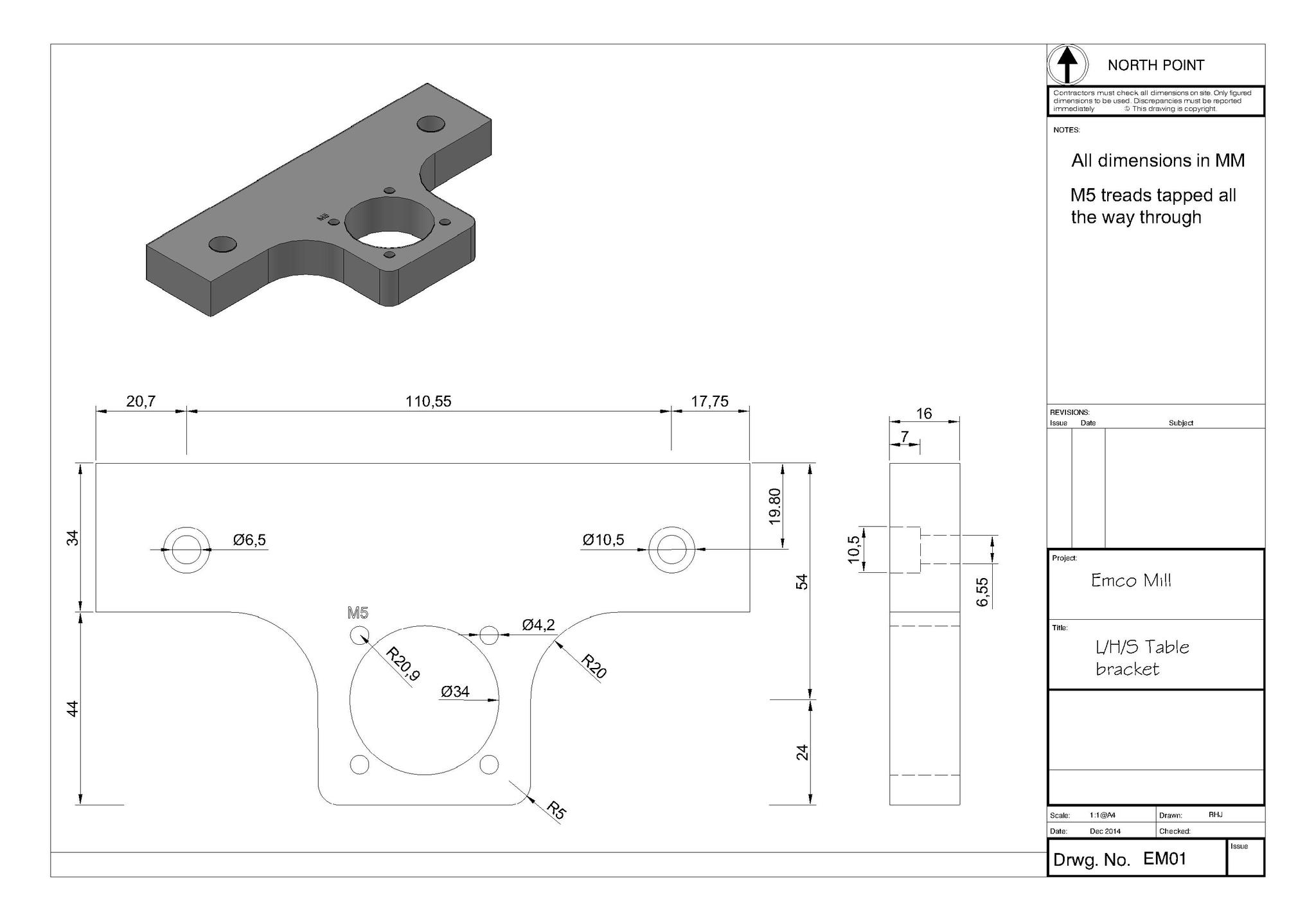

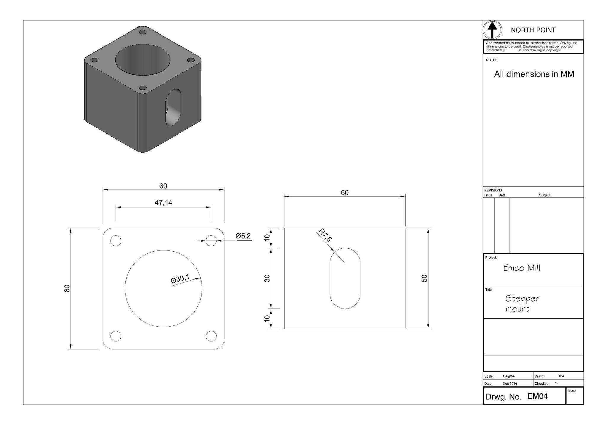

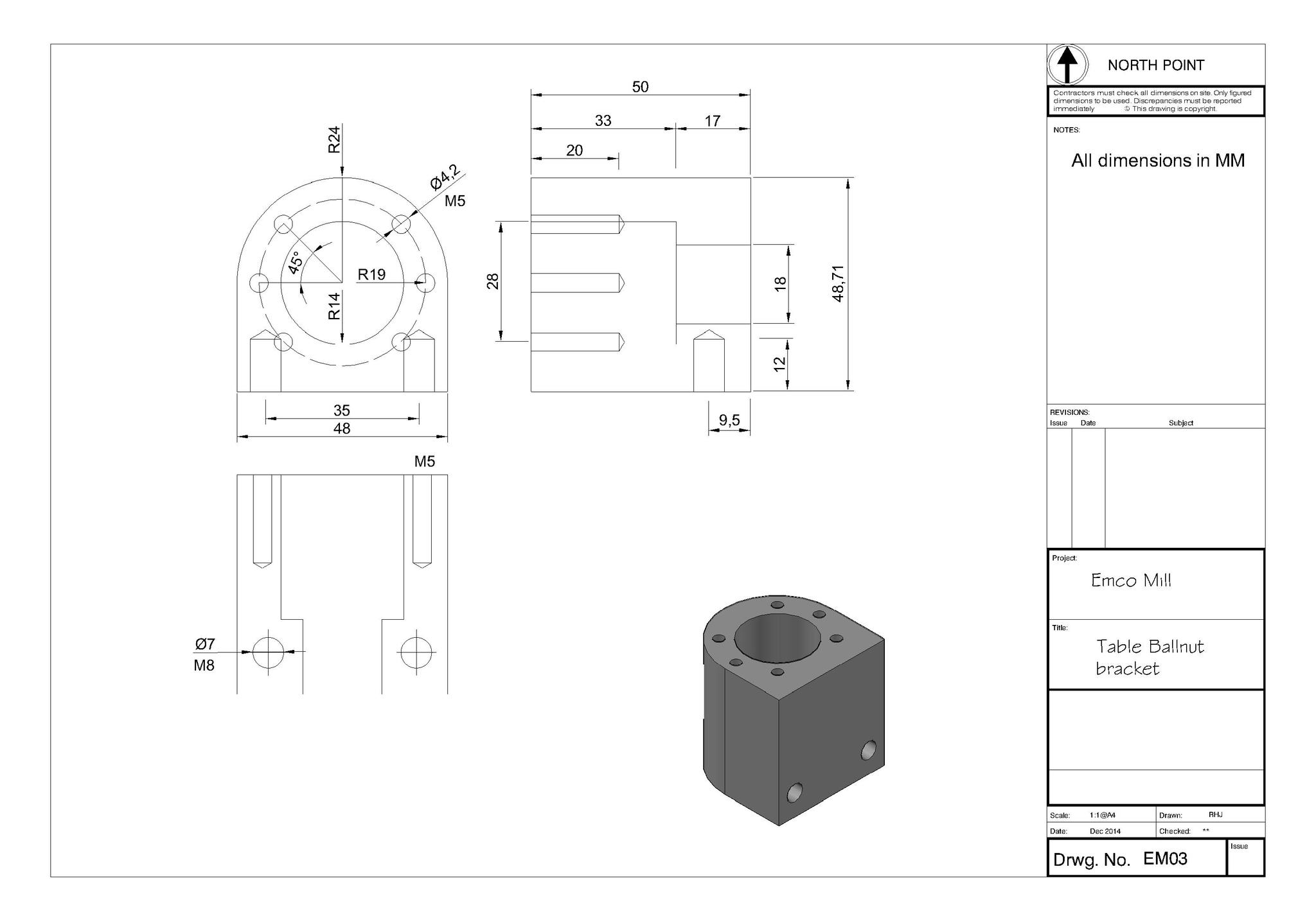

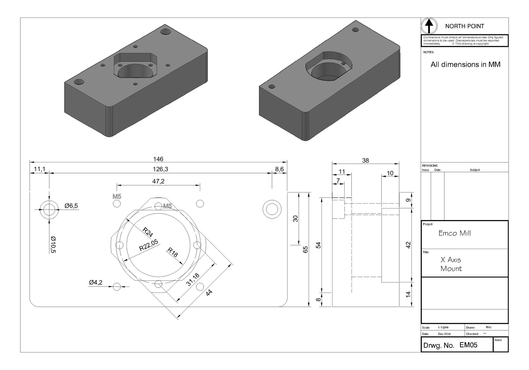

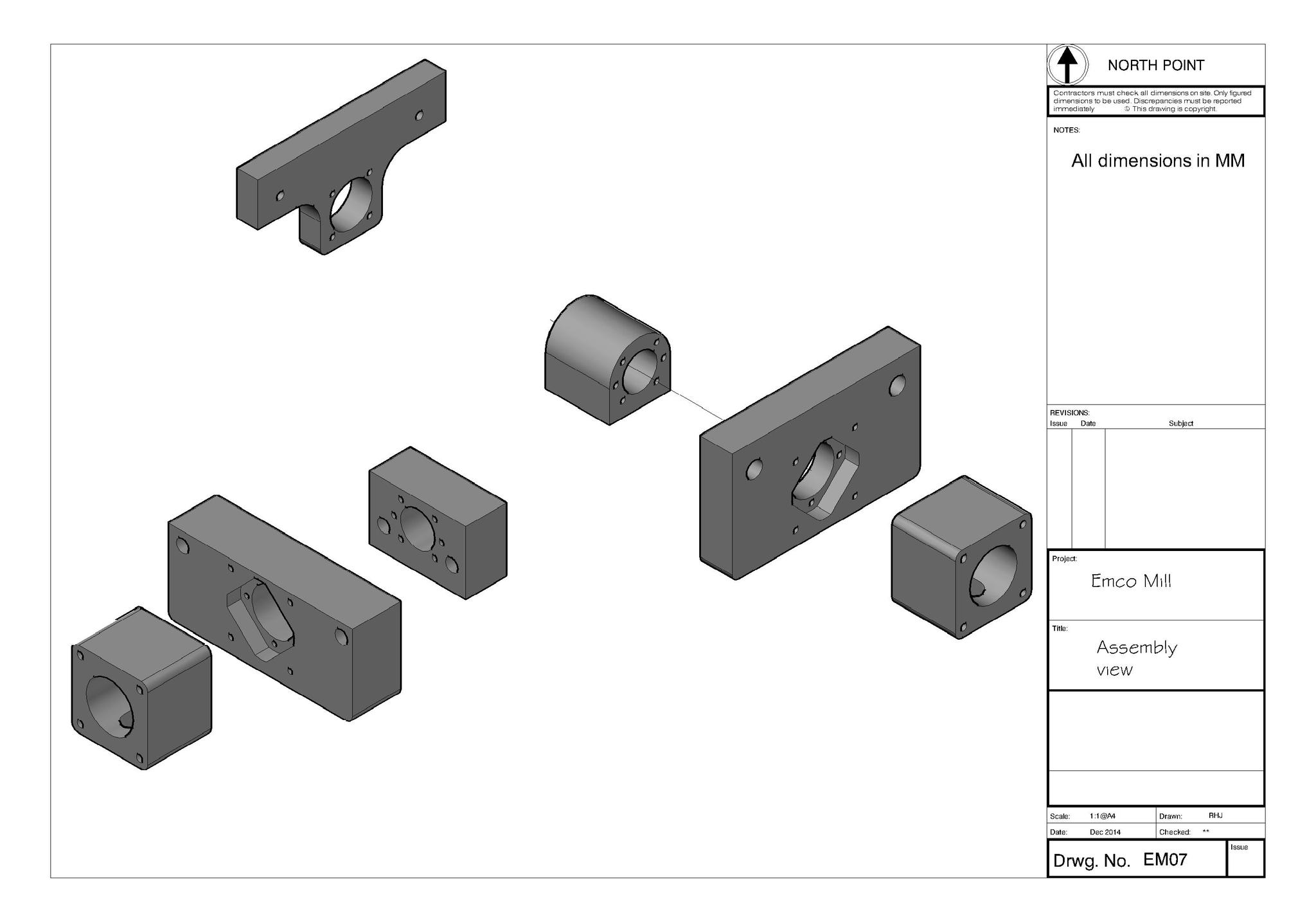

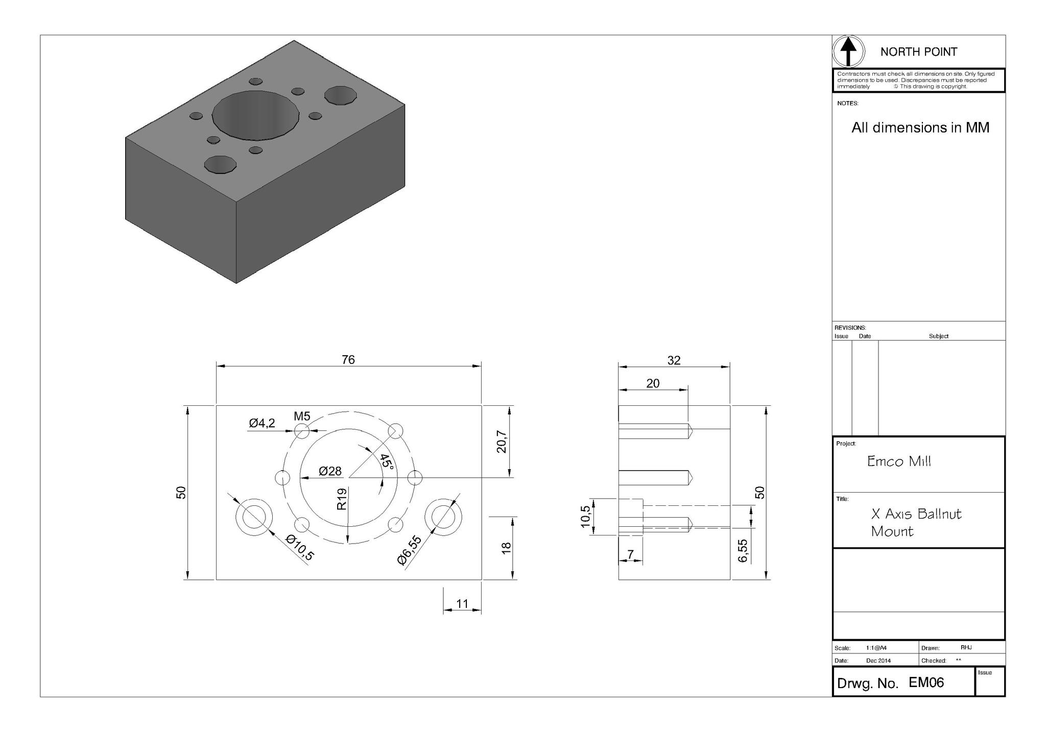

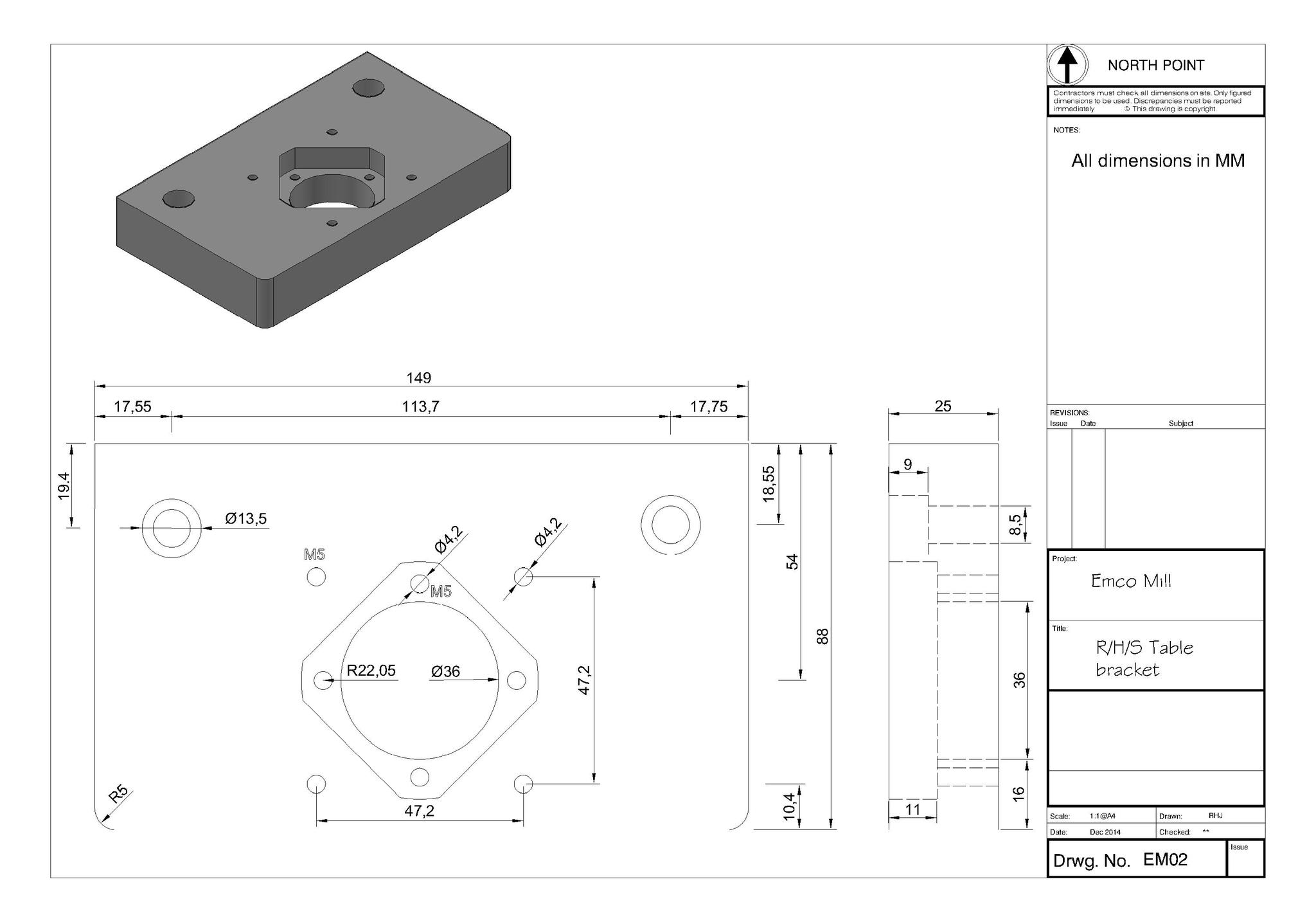

  9. #59
    Bit more progress. I have designed all the plates to convert the x and y axis to ball screws. looking to get these made up but before I put in a request for a quote what is the best grade aluminium to specify?
    Also not sure if the motor mounts already exist so If any one knows where I can get them off the shelf then please let me know. google and ebay seem to throw up box section hacks.
