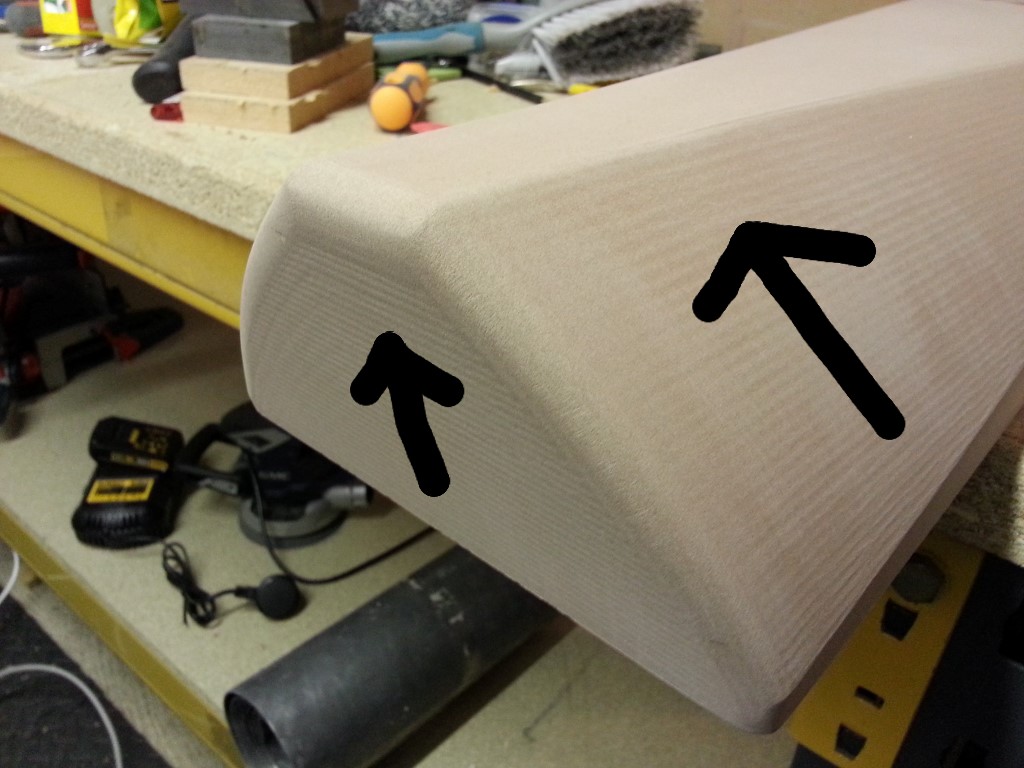

    I've got some weirdness going on with the machine and 3D profiling.
    Take a look at this:
Name:	CNC Steps Dir.jpg
    The arrows show the tool path direction along the profile. What I'm getting are ridges that run perpendicular to the step over (ie. if you step over top to bottom, the ridges run left to right). Just to be clear this isn't a step over ridge I'm talking about and something else is going off here.
    What could be causing this sort of thing?
    I can say this -
    • The pattern is consistent and almost looks part of the g-code?
    • It doesn't matter which axis you step over in X or Y.
    • Also doesn't matter what the profile shape is or the angles involved.
    • Its speed independent I've tried 1m/min upto 10m/min and nothing changes.
    • I'm using Mach v3.43.66 with Solidcam.
    My first first I thought I might have some backlash somewhere but the pattern is very consistent even over a large area with many hundreds of step over passes. I've also ruled out loosing steps as the overall finish piece is as intended and doesn't deviate from the original model. Lost steps would normally be very easy to spot by the end of a large 3D job. No problem with that here.
    Hope someone can help.
    Ps. There's no jerky movements and machine is smooth whilst running the 3D profile as shown in this vid:
    In picture, right hand side long profile.
    You say you are cutting up down and querying the pattern that lies horizontal ?
    If I have read this right then the pattern is very regular, in fact it looks cyclic.
    One clue would be to measure the ridges and see if the measuremet tied in with say ball screw pitch.
    Another thought is that on that profile it will be working Y and Z can you try a sample using X and Z ?
    Last thought is to post a section of code that covers one of these passes.
    Don't post the whole code we only have until 2020.

    Yep exactly that.
    Its working on both. Also in that pic you can see the same pattern on the other face although this is more tightly spaced. Could this have something to do with ball screw pitch as there's more Z movement there and that's 5mm pitch whereas its 10mm on the others?
    Here's a section from the very start of the 3D operation.

    What happens if you run it at much lower speed? You could be getting bounce back from the material?
    Quote Originally Posted by Swarfing View Post
    I've played around with the feedrate as low as 1m/min which is as gentle as a mill pond. Same results.
    D.C.'s Avatar
    Could it be the material itself and not the cutting process, in other words is it lamination showing through?
    Quote Originally Posted by D.C. View Post
    I get the same pattern on both high density polyurethane block, mdf and valchromat so I don't think its the material.
    dsc's Avatar
    Lives in Lincoln, United Kingdom. Last Activity: 17-06-2020 Has been a member for 9-10 years. Has a total post count of 252. Received thanks 1 times, giving thanks to others 11 times.
    What I'm about to type might be stupid, coming from a person with no CNC experience, but isn't this caused by the movement being done in two steps, rather than simultaneously? so instead of moving say 1/4 step up and 1/4 step left at the same time to get an angled movement, it first does 1/4 step up and later on (scan later?) a 1/4 step left, which results in a step made in the material.
    Regards,
    dsc.
    Since the ridges seem so consistent, they could be part of the original CAD model. For instance if you imported the model into the CAM program as an STL, then that approximates the surface with triangles. If the resolution of the file is insufficient, then you will see the flat surfaces left by the straight line approximations to a curve. Look very carefully at the model imported into the CAM program to see if you can discern any pattern.
    Similarly it could be the G-code being generated at too low a resolution, so using lines a few mm long, instead of arcs and lines which are too short to see. It's hard to tell from the code you posted. Can you post a bit from the main profile section, i.e. somewhere in the middle?
    Lives in East Lothian, United Kingdom. Last Activity: 7 Hours Ago Forum Superstar, has done so much to help others, they deserve a medal. Has been a member for 9-10 years. Has a total post count of 2,908. Received thanks 360 times, giving thanks to others 8 times.
    Check Jonathan's suggestion.
    If you look at the code, there are jumps in the Z.
    It starts of with relatively small steps around 0.05 rising to about 0.2, however there are 3 distinct jumps.
    Line 110-115 Z moves 0.597, 225-230 it moves 1 and 340-345 it moves 1.965. I know those big moves also correspond with big steps in X and Y, but it does mean the code is a bit inconsistent, and may cause havoc with the projectory planner.
