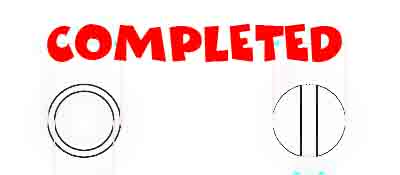

    I'd like some precision screws and caps made in stainless steel (316L preferred). The smallest part is approx 1.6mm x 4.3mm tapped with a M1.3x25
    Quantities from 200 upwards.
    Please get in touch if you can help
    Thanks. Mike
    see attached pic below showing the dimensions i need.

    That looks like a real fiddly job with lots of broken taps and scrapped work pieces. Tapping a 1.3mm thread into a blind hole is a nightmare in any material. Doing it in stainless steel is certainly not helping matters. Also, you'll need to make allowances for drilling and tapping depth as I very much doubt that anyone will be able to create a flat bottomed thread like you have drawn.
    All in all, a bitch of a job and likely to be very expensive.

    birchy, thanks for your input. I'm a newb with illustrator and glad it allows me to get my idea across.
    Now that you mentioned it, the other end that screws into that cap is threaded shorter so i will need to show the machinist there's allowance.
