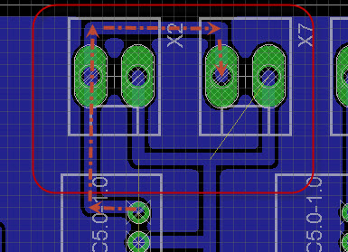

    Question on PCB and routing , well more .. will it work I guess ? Anyway I have hammered the tutorials and finally got to where I think I can start to mill the board. Only thing is is a question on power voltage etc. as you can see I have highlighted my concern in a red box , this is two molex 2 male pin plugs , I want to draw power from both as they go to different parts of the hardware .. will this work ? Will this affect the voltage ?

    and blew a close up :)

    any help as normal appreciated :) only had four beers so far .. record lol BTW the board is tiny only only 60mm x 40mm .

    As long as your within the limit of what the regulator can supply AND the traces are wide enough for the current desired, it should work.

    Depending on current, it may mean a slightly higher voltage drop at X7, however provided that whatever you're powering from the connectors aren't going to be affected by noise/voltage spikes from each other, and you're not going to overload the tracks, it'll be fine.

    I've made the traces as wide as possible, I think it should be able to handle the current , suppose I wont know until I try it Bubba lol , again thanks for the reply mate :)
    Hi MC , nah the last on the rail powers two 5v servos the first powers a raspberry pi , i'll have to rethink if it drains or spikes to much, but they are 7 quid a pop I would expect then to have some umthh ! lol

    Use this: The PCB Track Width Calculator to calculate track width...
    Incidentally, 3-pin regulators should have 10 - 100nF ceramic capacitors on input and output else things can get noisy. See their datasheets.
    Hi Irving hope your feeling ok , they are used for pure power no signal its just a drop down box.

    read the datasheets... HF noise on power lines can cause all sorts of issues.. trust me, been designing electronics for 40 years!

    So you think I should add 10k's at the voltage out ? I'm going off the guys schematic , he didnt include them only on the data line.

    I normally include an electrolytic cap on the output of linear regulators, then add a ceramic near the input of anything that may be affected by noise.
    Although things may work without caps on the linear regs, it's not good practise. Lots of linear regulators specify minimum capacitence on the output lines in their datasheets.
