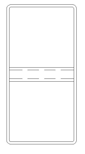

    How about using a thinner wall and reinforcing with either plates or tubes inside the box? The tubes go across the inside faces to prevent the walls collapsing when you tighten the bolts...

    Well, that's an option, I guess, but it'll probably be quicker and less hassle to bite the bullet and just drive down and collect the section I want - positioning a plate or a tube deep inside box section sounds like a bit of a ball-ache - especially as it'll have to be a tight fit for it's intended purpose (bracing the walls).
    Cheers.
    Wal.
    Normal practice with the tubes is to saw them to about 0.5mm undersize a tack weld them inside the box. Obviously you can't do that if your holes are not near the ends of the box.
