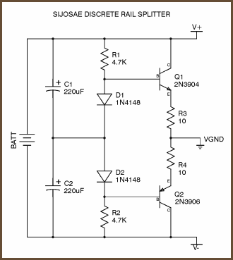

    My Idea was to use this
    Then someone mentioned TLE2426 would work better as long as I'm only drawing 20 - 40 mA

    The above uses a single 9v battery , anyway I'm going to buy the a TLE2426CP from farnells even though they are nearly 50p more than Mouser, but its free shipping ..hehe and breadboard it.
