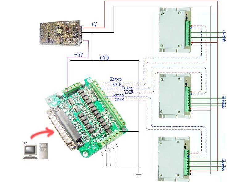

    I'm currently working on my driver box and it seems to be going okay (thanks in no small part to Clive.S - a top bloke who has helped me out massively) but as Clive is using a different BOB to me, I thought I'd throw my plans out here to see if I was heading down the right path...
    I'm using 3 Wantai drivers (DQ860MA) at 70v along with the free BOB that comes with 'em, which I'm powering from the integrated 5v auxiliary on my power supply.
    The first question - if you look at the picture of the BOB - how come there are 2 sets of inputs for the power - my board has them marked as +5V/GND/GND/VDD - or is the idea that you power the board with one set and are then able to take power from the other set?
    I know that P1&P2 are intended for XPUL and XDIR respectively. P3&P4 are intended for YPUL and YDIR respectively and (yep) P5&P6 are for ZPUL and ZDIR. I've also been told not to worry about the ENBL+/- pins for my application.
    So, with that in mind, will this wiring work:

    Or, should I use P1&P2, P3&P4, P5&P6 to go to the PUL-/DIR- pins of the drivers and then take multiple wires from the VDD terminal to all of the PUL+/DIR+ pins?

    Ok well don't know this BOB but I'll take educated guess and say that VCC is the positive to power the board and GND is obviosly the ground.
    The +5v & Gnd will be a output the BOB provides for powering other things.
    Regards the wiring then Yes the diagram is correct and will work. Don't take power from the Vdd to the Pul/dir.
    Can't see the Linux link but again I'll take a guess.? . . . Chances are he's done this so when there a Limit or E-stop it disables the drives but doesn't Kill power so the Motors stay Energised and don't lose holding torque, the Enable just stops any signals getting thru.

    Just found a bit more info on these drivers over at the Wantai site:
    When the high electrical level is active, all control negative signals will be connected together to GND. When low electrical level is active, all control positive signals will be connected together to public port.
    Which I guess translates to:
    • If your parallel port pulses at 3v then connect all the positive pins on the driver to +5v on the BOB and the negative pins to the control pins (2-7).
    • If your parallel port pulses at 5v then connect all the negative pins on the driver to GND on the BOB and the positive pins to the control pins (2-7).

    Here:

    Make sure you set the step outputs in software to active low.

    Hmm, so nothing connects to the PUL-/DIR- pins on the driver...?
    How can you be sure that this is the case? Would this not be entirely specific to what pulses my parallel port is sending..?
    Oh yeah - PM me your PayPal details for the spindle mounts, man!
    Wal.
    Cheers Jonathan.
    They go to ground.
    With this setup, when the parallel port output is low the output of the breakout board is 'open', so the driver pin will be pulled high. It's therefore inverted, hence the parallel port needs inverting to restore normality.
    Any idea how to do this in LinuxCNC?

    Okay, so I connected an axis up using the control pins (2/3) to PUL+ / DIR+ respectively with the PUL- / DIR- going back to the GRND on the BOB.
    Nowt.
    Set the step outputs to 'active low' - thanks again Clive for pointing out how to do this: check the 'invert' box in the Parallel Port Setup window (Stepconf utility)
    Still nothing.
    After a fair amount of head-scratching I measured the voltages coming into the PUL+ / DIR+ terminals on the driver - I know that it's gonna fluctuate when the 'test axis' utility is running, but the voltage was peaking at about 2v, both at the driver and the BOB. A bit more head-scratching before connecting the control pins (2/3) on the BOB to the PUL- / DIR- and +5v to the PUL+ / DIR +. Output pins still set to 'active low' and hey presto...
