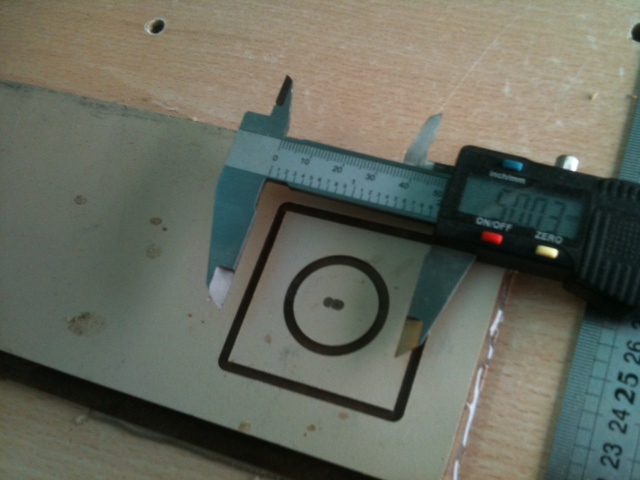

    Now about the final accuracy i achieved. Today i run it for first time cutting. My typical starting test is 25mm OD circle in 50mm square
    Pictures speak better than words but lets say that all the careful fiddling payed itself and the final/accumulated/ accuracy of the machine without any compensation on mach 3 motor tuning and so is 0.01-0.02mm or less , having in mind that the digital caliper measuring may be not perfect. As you can see perfect super clean circle cut. No mismatch or whatsoever.
    PS.The bed is 5cm thick so the Z at the test was extended at its lowest point.

    Just installed it at its new home. The precision continues to surprise me. Instead of accumulating, all small imprecision neutralized each other, may be pure luck but still under 0.01 -0.03mm, it seems i can not measure it properly without introducing error. No need though, i am happy.
    Surfacing aluminum resulted in glass like surface, small marks are not seen by naked eye and scratch test with fingernail leave impression of trying to scratch glass.
    The C23 Bob works like a charm. But the integrated spindle control is erratic. I supply it with 12v stable voltage and it plays the output to spindle with 0.2v witch translates +-200rpm, which makes the spindle sound annoying. Will contact the maker. As i see it i will change the small pot with a big one external, in the hope to cure this problem. All PSUs i use are overrated at least by 100% and brand ones, so may be its the pot.
