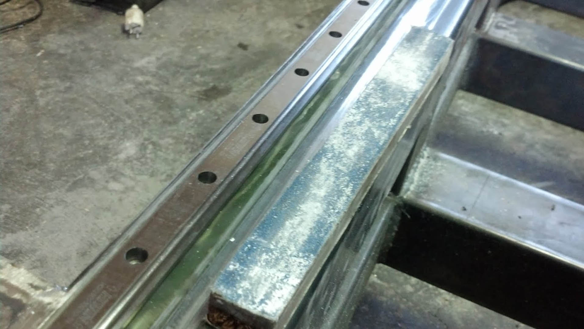

    The Hiwin are wide 20mm, i made the epoxy 40mm wide, hence-10mm each side. Thats should be the proper way. The meniscus took like 3mm at least.
    So how i dealt with the meniscus? I decided i would not waste time on it, so i glued sand paper to a stick and started sanding it off. Not completely. I decided i will mount the rails and then continuing with epoxy leveling the gantry rails and side supports.
    In other words dealing completely with the meniscus is a waste of time. The process took me 20 minutes, the epoxy sanded like a snow flakes. 20 min more for the end of the epoxy, where the end of the rails would be. here i checked with straight edge and scraped a bit the last cm.
    It is a very good idea to stuck a tape over the middle of the epoxy, where the rails would be, as not to scratch it!

    Well, it seems it worked as supposed. The epoxy i mean

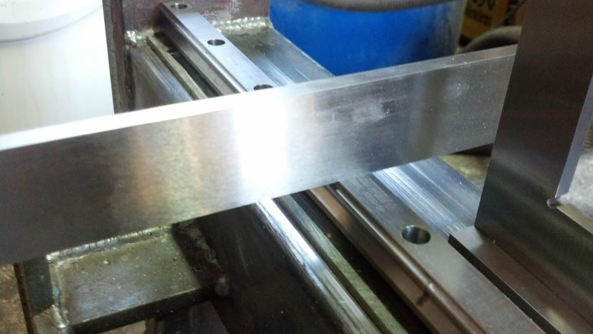

    Buying the precise 1m straight edge and precise square was a very good idea. In a matter of minutes i placed and aligned the rails. I would say that its crucial .
    Both cost around 100 euro and a week research , see here: http://www.mycncuk.com/forums/tool-t...-straight.html
Name:	epoxy hiwin 3.jpg

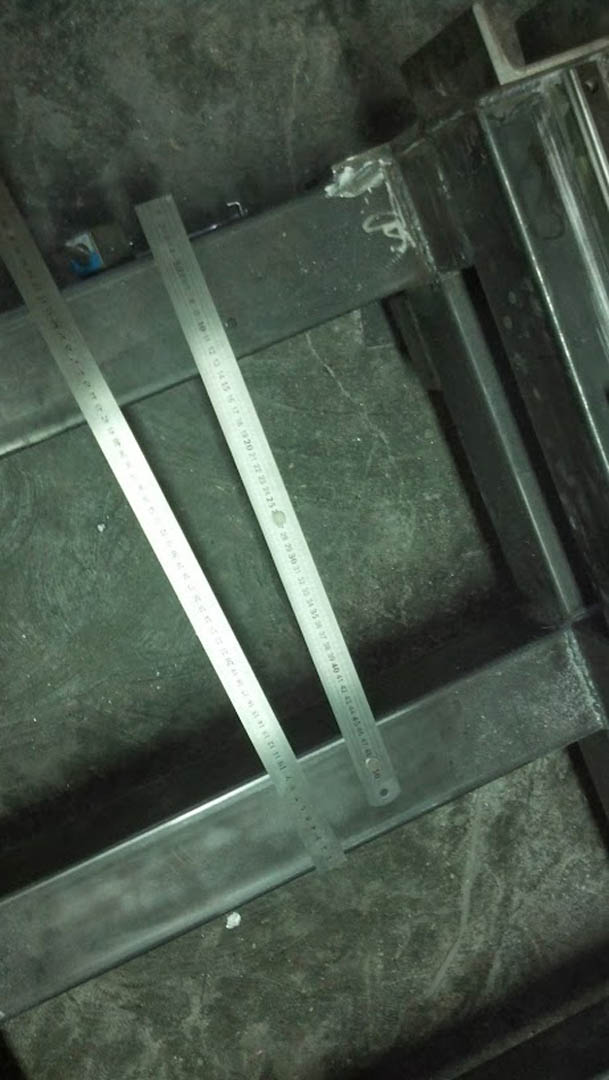

    Once in place and squared i rechecked them using a long steel ruler made from 2 rules and magnets, which i fitted inbetween and checked at both ends. Tight fit as expected. I supported it with alu beam so it would not bend/ like in the picture, while i was making the shot/

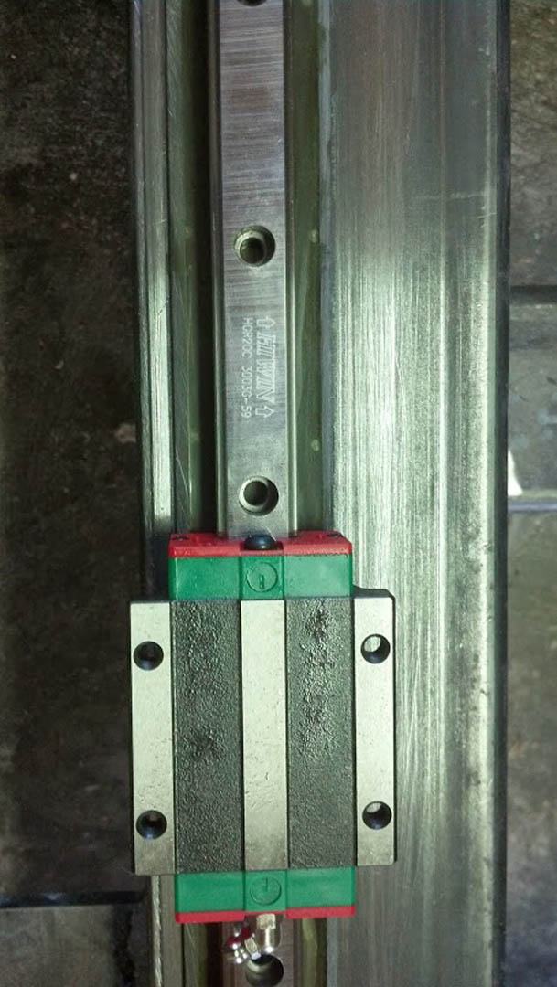

    Just a side note here. Forum is ok, but read the frigging manuals. Hiwin rails have direction, also the carriages/ its not seen on the pic, but the letters should be at the side where the arrow points to/ . have that in mind, is buried somewhere in the long manual.
