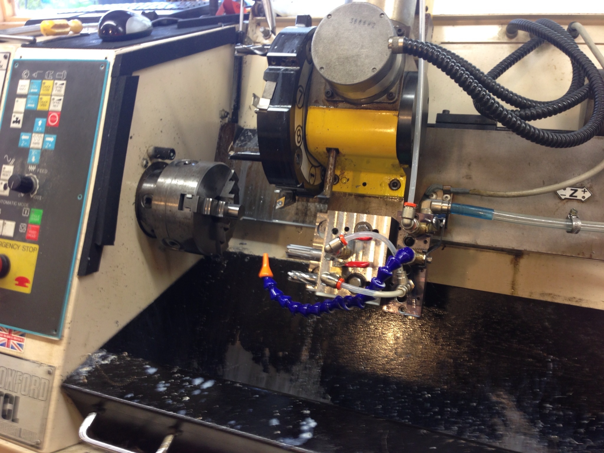

    I think I have reached the point where I need a proper cnc lathe, I have been using boxfords for production runs.
    Need something faster with auto bar feed and will keep accuracy all day. The parts I turn are small, no more than 25mm in dia and 100 mm long. I have only single phase ,so it would need to run on a single to three phase converter.
    Gang or turret tooling.
    Any idea where to get such a machine or recommendations on a machine.

    The haas is single phase though isn't it. Probably very costly though. Away to check that link you posted

    This is what I am using at the moment, need something more capable
