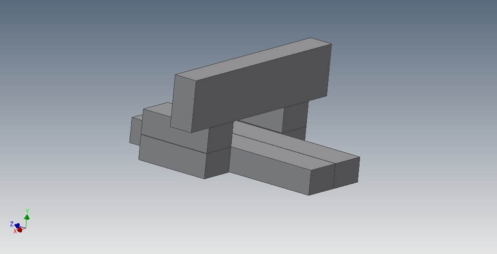

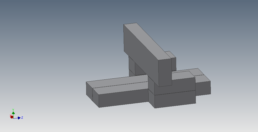

    I've been looking at prestressed concrete lintels. They're concrete and huge so have fantastic vibration dampening, they're designed to take tensile load which concrete is usually poor at, they're precast so have very little shrink/creep left to do, and they're cheap. A lintel 215x140x900mm costs £30 and has a "safe working load" of 83 kN/m (whatever that means).
    This leads me to the attached beginnings of a design for a router frame. It would have travels of 400x600x100mm and mount a 2.2Kw Chinese watercooled spindle.

    To build I would:
    1) build a heavy duty table to carry the whole lot
    2) bolt & cement in place the padstones that are the support for either end of the gantry.
    3) level the table top with self-leveling epoxy
    4) Fastened together the 2 base lintels by steel straps at their ends, and epoxy level on side.
    6) place the base lintels on the levelled tabletop, level side of the lintels down (level touching level)
    7) epoxy level the front face of the gantry, cement the gantry in place using a digital spirit level to ensure the face is true vertical; then epoxy level the top face of the gantry if we need that.
    7) epoxy level the other (now top) side of the base lintel pair.
    8) Put a bolt though one corner of the base lintels, and hold the other corners down with bolted straps.
    9) mount the gantry & Z carriages, wire up everything
    10) mount the moving t-slot table
    11) machine the moving tslot tabletop flat
    12) adjust the base lintels (swinging around the bolted corner) to square up the machine, using test cut pieces and a micrometer to test for squareness.

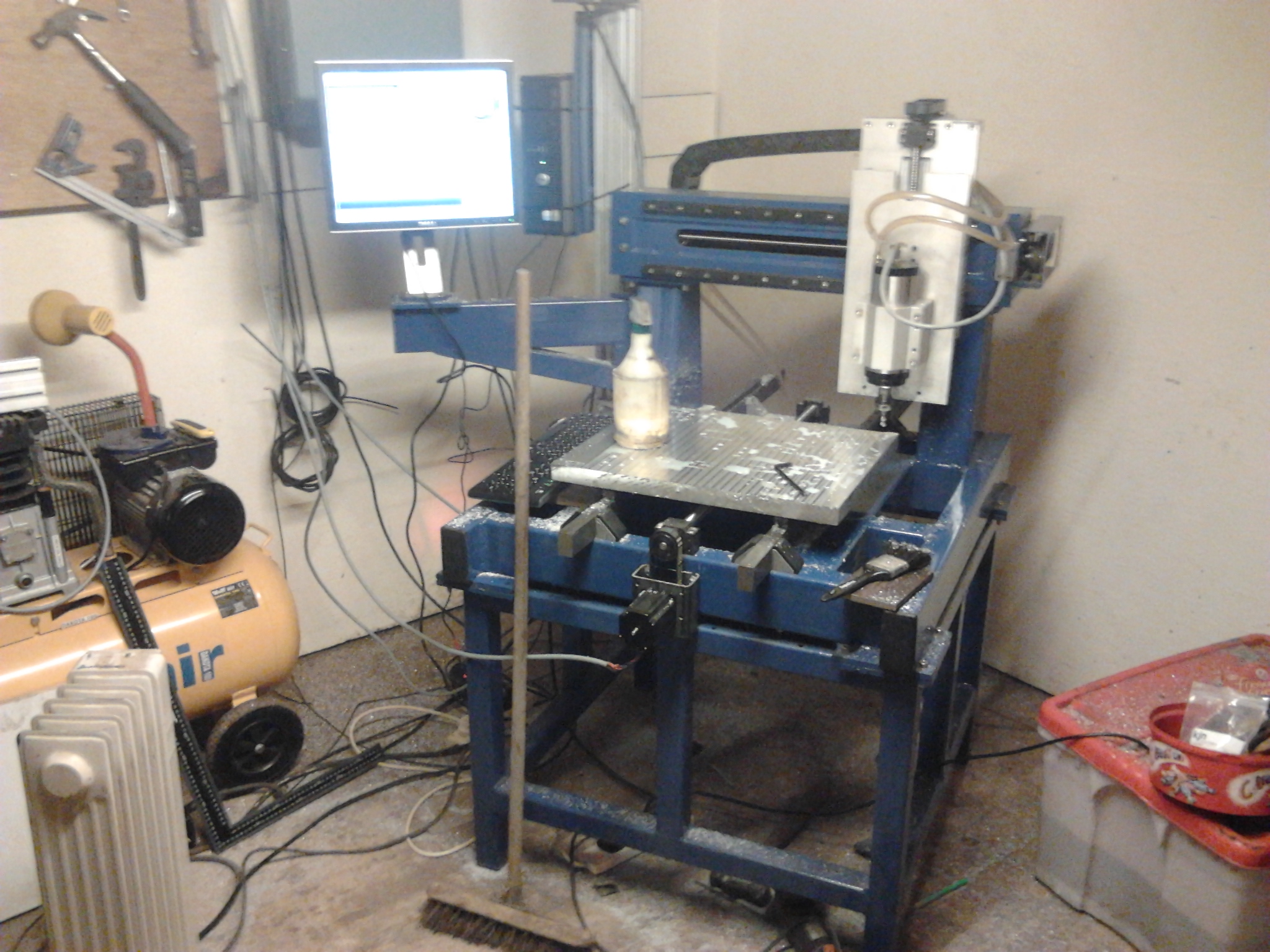

    i had a crack at a fixed gantry 400x400 mm work area,i,ll be pulling it apart soon and upgrading a lot of it.
    i noticed your gantry is positioned on the halfway point of the bed but it will look very different once you factor in how far the z setup/spindle and mount pertrude,you want the center of the spindle to be at the halfway point of the bed.

    cheers i wish id had a bit more patience though, changes.
    the x axis is being stripped down

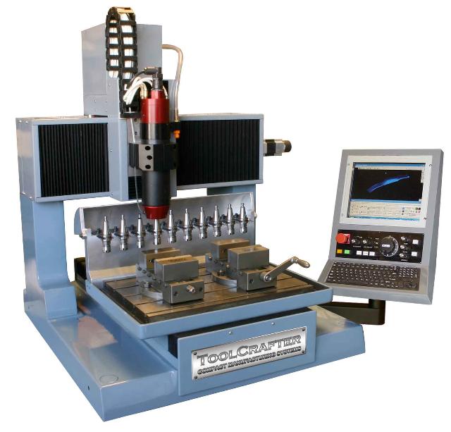

    plan is to completely sheet off the bed like the one in the image below ,then 1 big 20 or 30mm thick plate running down the centre that will be slotted to take the slightly longer 20mm rail (that ive got to order),i should roughly get an extra 200mm of travel.
    y axis im scrapping and starting again too much to list on the lads thread,so a new thread sounds like a plan ta
