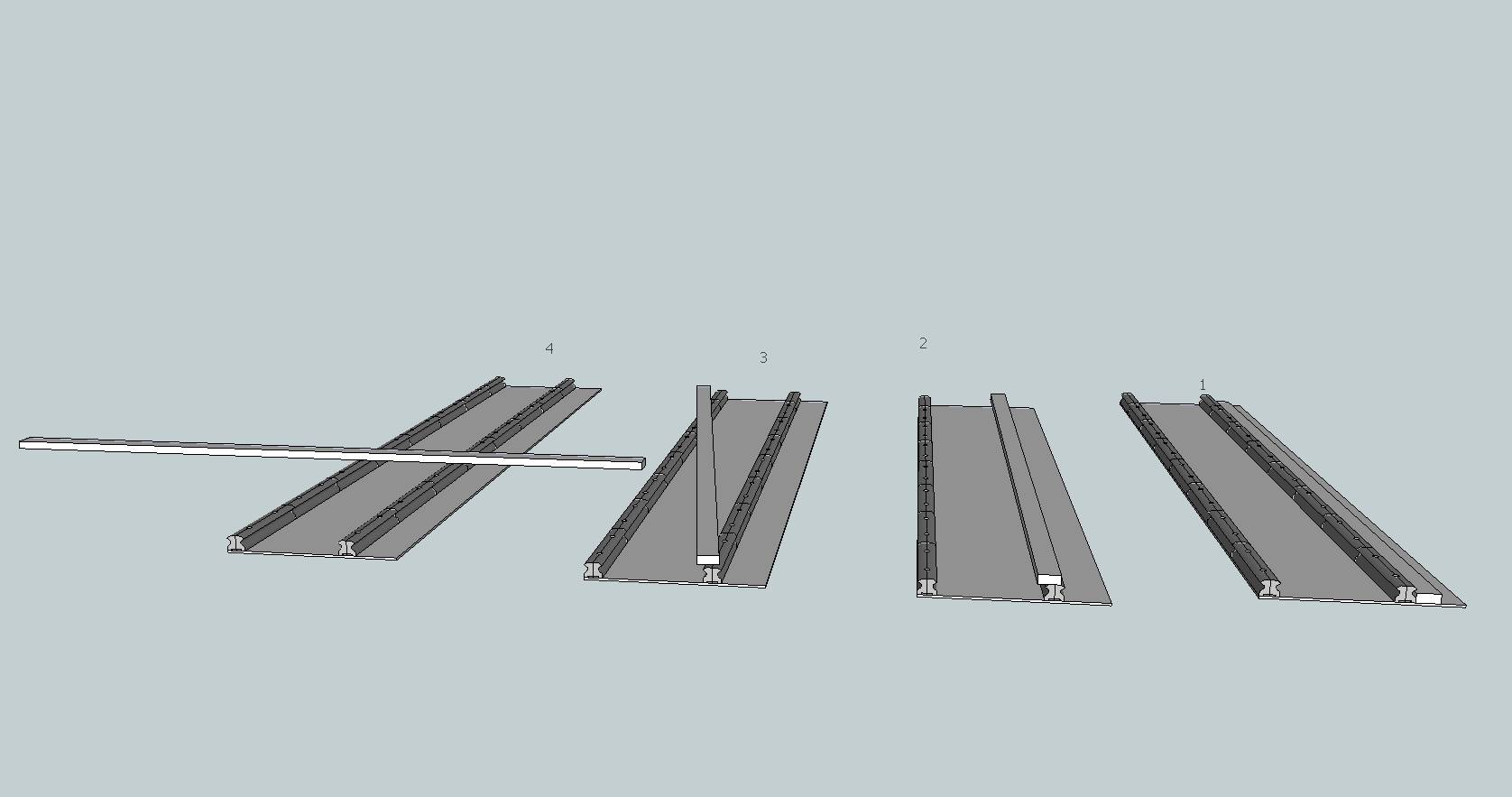

    I was interested in the straight edge, for checking the gantry profile after welding. And as i have nowhere to machine it and havent found around where to do it, i was contemplating checking and filing until is flat. i believe its called " elbow grease " in English.
    My idea also was to do the same with Bosch profile i have, as its quite straight. The small triangles i bought as i needed sth really straight as a starting point for all projects.
    maybe i am wrong, but how to make a precision machine if i don't have a straight ruler to draw straight line?
    Apart from parallel i would like the Y rails / the long ones/ to be straight, not just following each other curvature. Any other way to do this with simple tools like a Bosch profile?

    The 2 angle finders from aliexpress will wait for the moment. My idea was to use them like this:
    Look at the gantry picture bellow. Using the straight edge or epoxy , like for the long rails, i could flatten the upper side/1/
    But then how to flatten the opposite side? I don't have a fixed gravity epoxy formed horizontal surface at home. If it was my proper house, i would have done it long ago. So just flipping sides and pouring epoxy would be simple. So i thought of connecting the 2 angle finders un U like shape so i can measure distance and parallelism bots sides. So using the epoxy leveled top or bottom as a reference i could file , sand and so on, the other side. if they were on one plane , it would be easier, but damned overhang...i don't like it.
    Anyways, i bought 2 packs of 1kg west system epoxy kit 105/209. After pouring some where necessary, the rest i will use to form a flat table surface and fix some short adjusting legs. As i have a very precise inclinometer / ~0.5mm per 3m, or so i calculated it when i bought it, don't remember but was the most precise on ebay/ i can fix me a portable level base precision surface for similar projects. I need a bigger garage:-)
