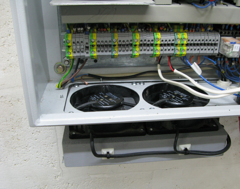

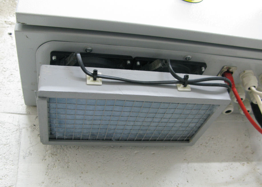

Gave me time to get the fans fitted anyway, something I was not looking forward to but not as bad as I thought. I'll probably fit a thermostat with a remote sensor in the hood.

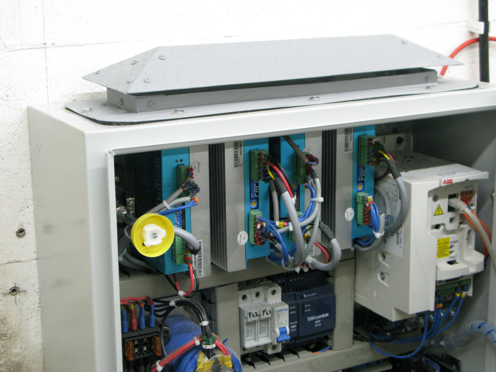

Two fans mainly because I already had them but they are 110 Volt so just wired them in series. Made a box with a sliding lid to allow easy replacement of filter medium, the fans are blowing into the panel pulling air through the filter medium. A vent at the top allows heat to escape by convection or forced by the fans, it does not allow crap to enter under gravity.
The wiring will have to be kept to the back of the panel as much as possible so as not to interfere with air flow.
(just ignore the temporary lashed in wiring)

I like that top vent, do you have a source for them?
I'm hoping they come in 80mm square versions. I currently have regular fan filters at the top to stop crud getting in but I think the air flow restriction they cause will be too great so a vent like that would be perfect. The alternative is to fit a couple more fans at the top but that then risks creating a negative pressure in the case.
