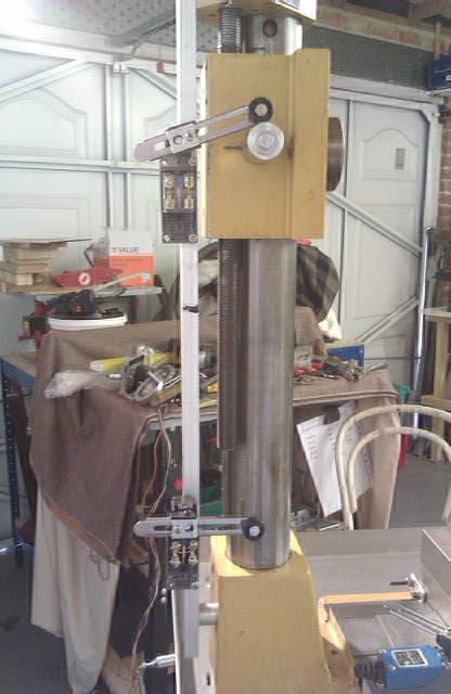

    Hi
    Yes there's 2, but very easy to install
    Something like this ?Click image for larger version.
Name:	Z axis Limit Switches.jpg
    Ray
