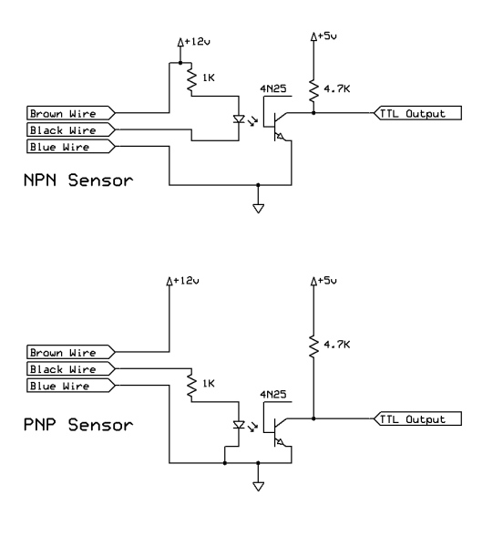

    I found this Click image for larger version.
ID:	9903 when I was looking for info on the proximity sensors I've got. Still haven't got around to fitting them though.
    Hope it helps.

    You might find this interesting:- Three-Wire Sensors
    It explains a little of how they operate ..Clive

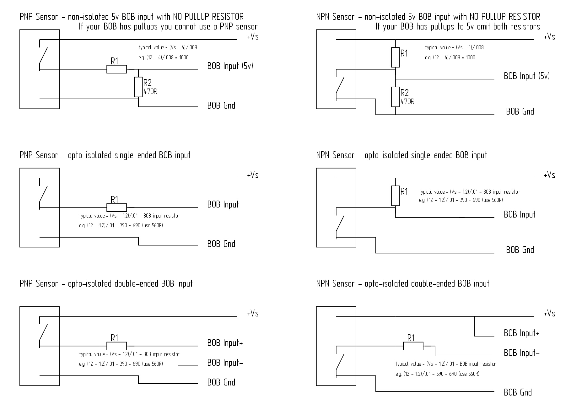

  11. Whats the supply voltage?
    These are open collector NPN sensors so your BOB must have pullup resistors and the external resistors are not needed.
    Diagram attached shows how to use both PNP and NPN open collector proximity sensors.
