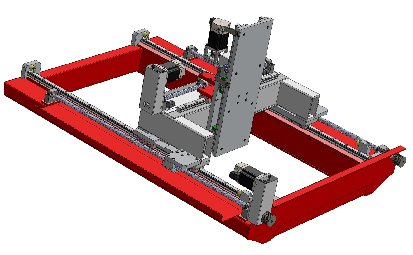

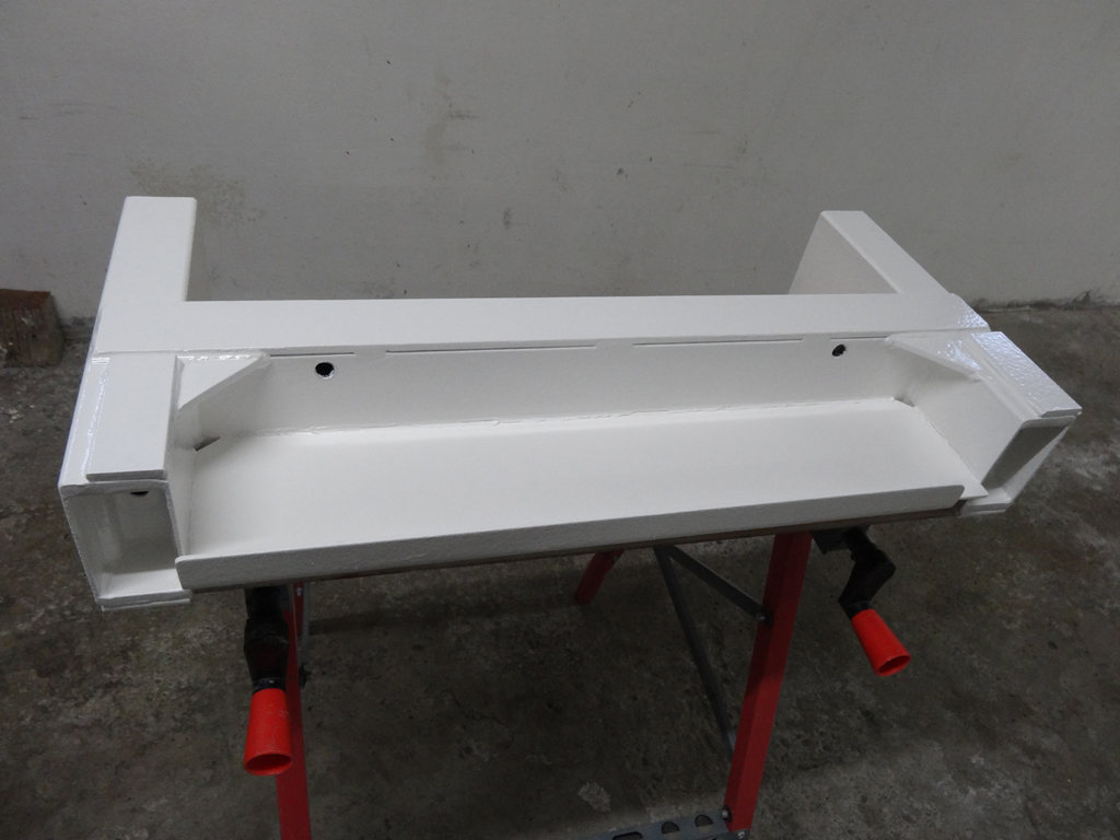

    I have taken some time to digest all the valuable informations posted on this thread and finally started the construction after some revisions on my design.
    The parts of the main gantry beam (supporting Y and Z axis) have been welded together and the tube sections filled with vibration damping material. It has been coated with epoxy paint for durability and ease of cleaning and it is now ready for machining to generate the reference planes and associated straight edges. The overal weight is now 17Kg.
    Some pictures:

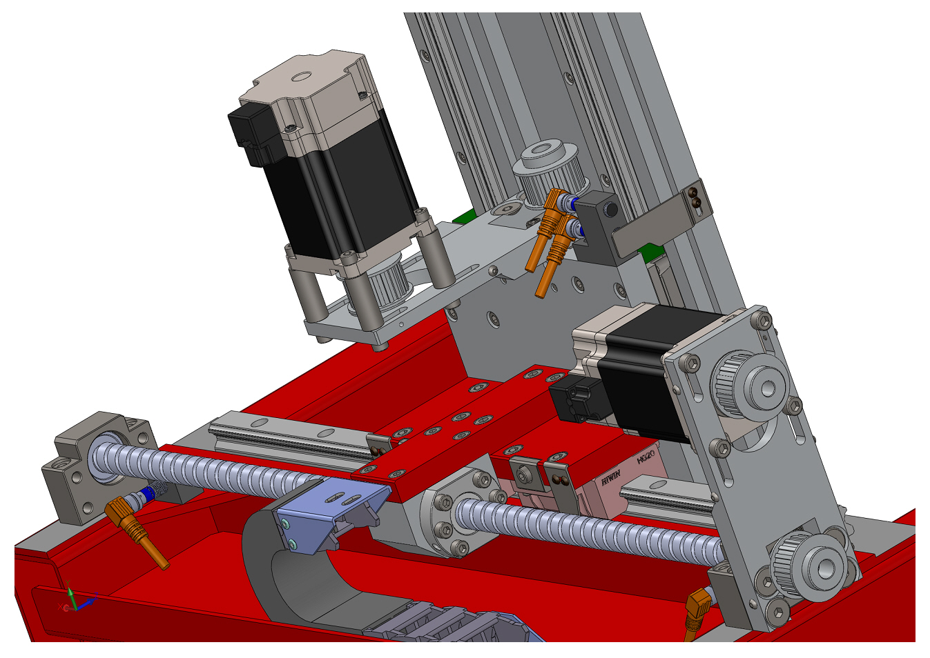

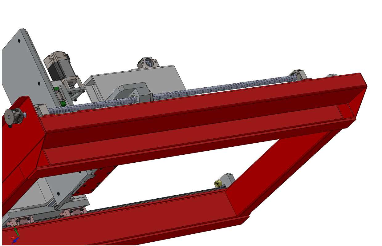

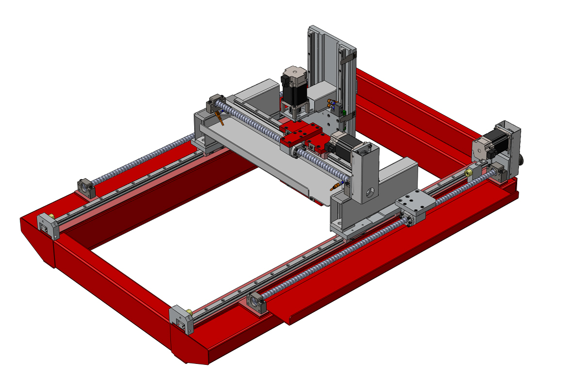

    As you can see, I've finally chosen to drive the X axis with its 2 ballscrew sets with one single stepper plus HTD 5M-25mm timing belt and 24 tooth pulleys. The belt tension device is not yet defined.
    The beams will also be filled with antivibration material compound.
    The rails supporting X axis will be leveled using epoxy technique.
    There will be a cover for the whole Z axis assembly and an other one for the front belt drive system.
    Need your advice for the axis end sensors: Do I need 2 sensors for each axis or only one sensor activated by 2 separate fingers (one at each end) ? What are you using on your own machines ?
    Looking for your comments.
    Philippe

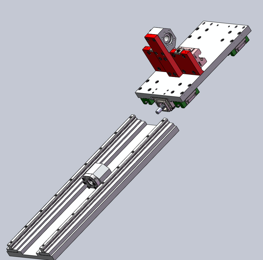

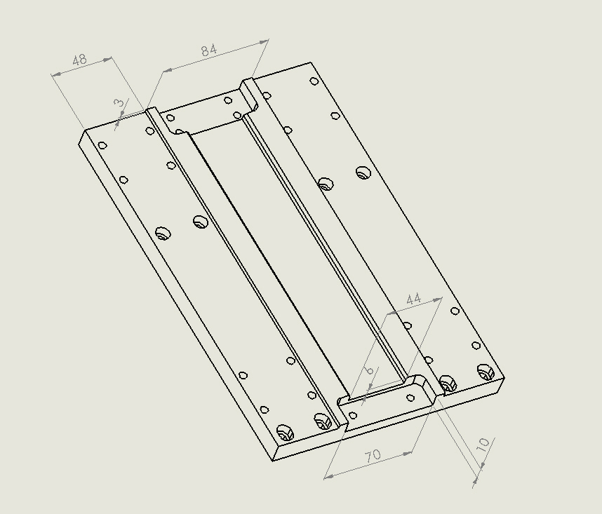

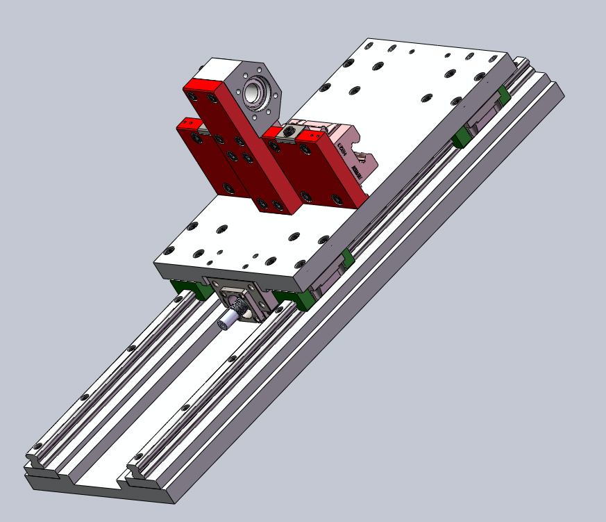

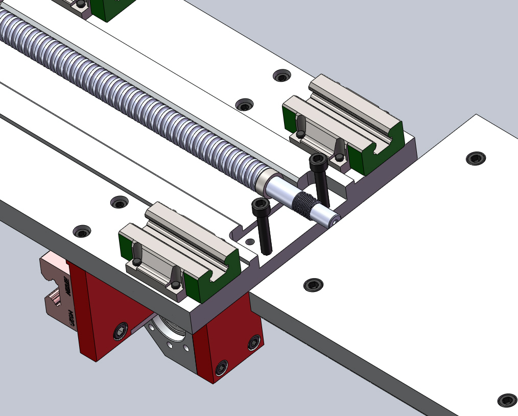

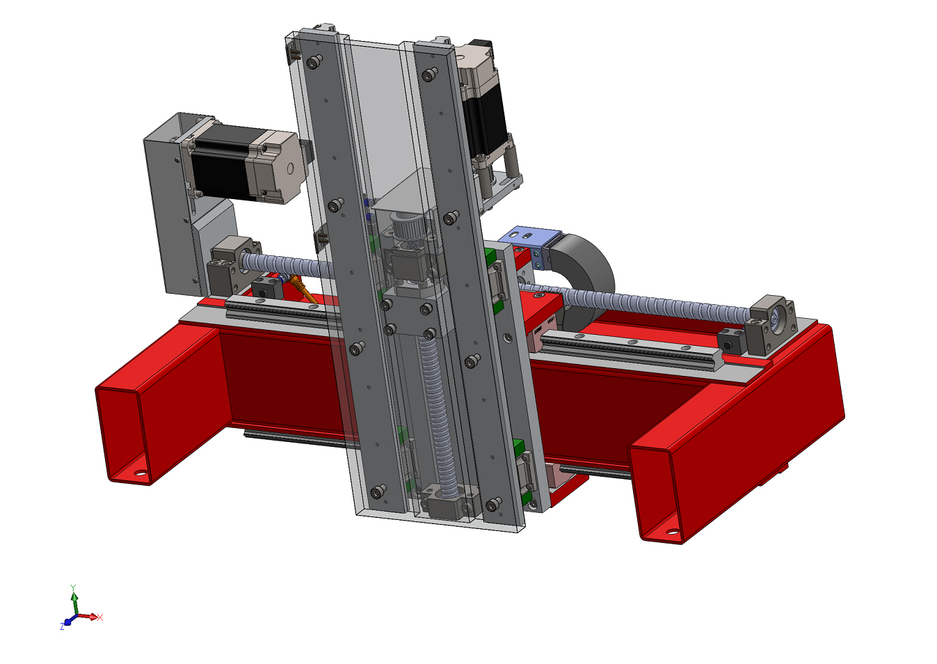

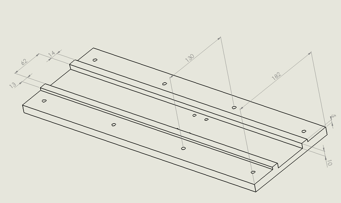

    Philippe,

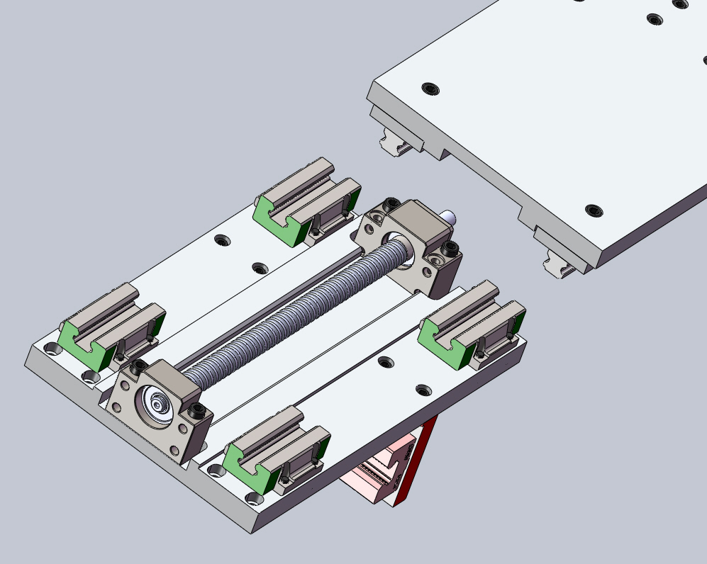

    I'm designing a machine which is similar to yours, although slightly larger capacity, and trying to use as many ideas discussed in this forum as possible.
    I am working on the Z carriage design and, as you said earlier, trying to keep the moving and fixed plates as close as possible. I cannot see from your CAD drawings how you have managed to fit the ballscrew nut in between the plates. The nut is wider than the profile rail + bearing height - have you put packing under the bearings to increase the space? I can see that you have machined steps into the plates and a recess where the ballscrew nut is fixed.
  8. #17

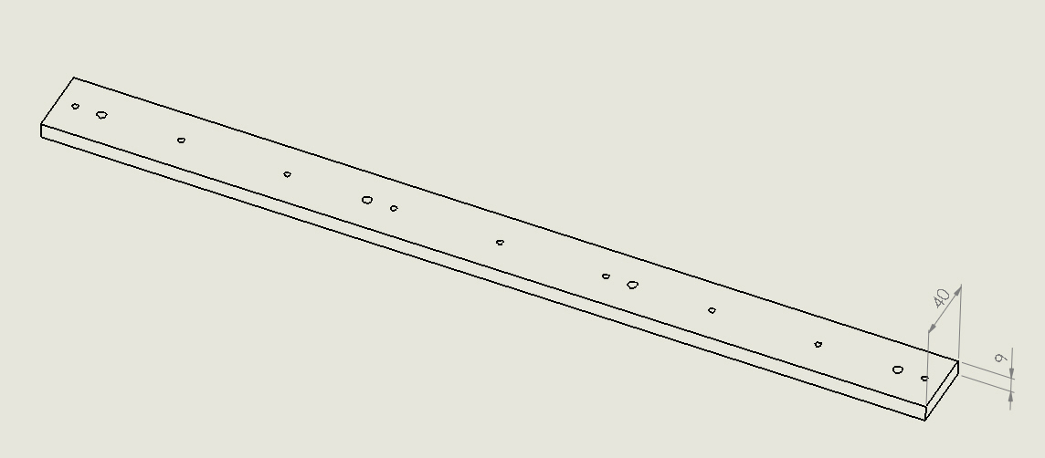

    Hi Neale,
    I'm happy to share related information back with you.
    I have broken the design so that you can see the area as detailled as possible. Let me know if this is what you are looking for.
    As a comment note that for the Z axis my rails are type HGR15 with Hiwin HGW15CA blocks and the screw is a 1605.
    Distance from Gantry plate to Z plate (plane supporting the blocks) is 24mm

    Many thanks for the details. I had started with 12mm plates but I think that you are using 20mm which allows you to machine recesses for extra clearance, and there are also packing pieces under the rails. Back to the drawing board!
    Are you using something like Solidworks for the drawings? The drawings of slides, ballnuts and so on are very detailed and look as if they might have come from the manufacturer!
  10. #19
    Yes Neal, using SW for the drawings with some parts already loaded from the web such as rails, blocks and M4 and M6 screws plus the timing belt pulleys. All the rest is own design.
    I do confirm that base material thickness for the plates is 20mm (initialy for ridgidity purpose) but helps making the cavities...
  11. #20
    For a small gain in strength and machining time, you should be able to make the recesses in the Z-axis not cover the whole length, as the ballnut doesn't traverse the whole rail.
