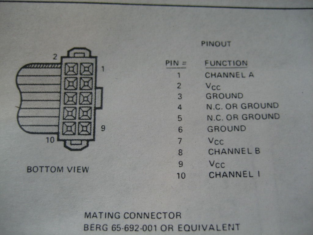

    That drive should work. However you need to ensure you have an incremental encoder, that outputs a quadrature signal (usually referenced as A & B outputs). You'll need to figure out eaxctly what the existing feedback device is, to see if it'll be any use.
  10. #20
    thanks again mc the encoders a HP heads-6310 021 a s. from what ive read it does use A & B outputs,id forgotten the schematics on page 1 so hopefully the pin info is in there
    edited heds 5000 and 6000 series encoders seem to be the same diagram,
