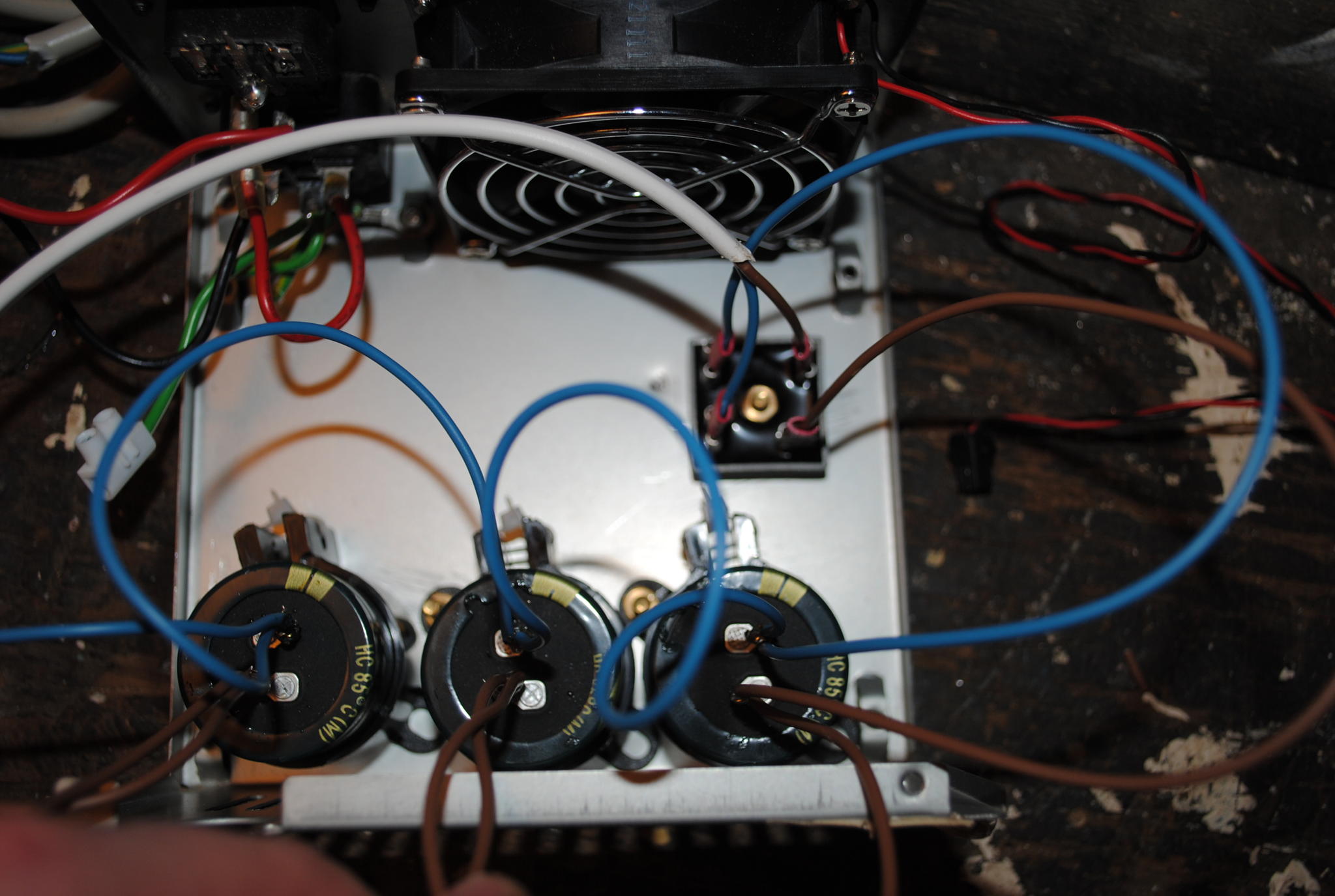

    I built my linear power supply today. When powering it, the only thing I heard was th transformer loading for two seconds, then a tiny "click", and I measured the output current of the PSU: nothing.. No fumes, no explosion, no bad smell, no heat, nothing was heard other than than a very little teeny tiny two second load, then click.
    So I unpluged wires, and checked each step separately. Turns out the transformer does not output current, even though it has proper 230V input current (checked). I tried with outputs wired in series or in parallel. Nothing comes out.
    Does anyone have an idea ?

    How did you measure the o/p current? have you checked the continuity of the o/p coils with an ohm meter.
    How have you wired it exactly. Has it got two sets of input coils? A picture would be good

    The transformer came with no ground wire, only load and neutral. Here is how I wired things:
    To answer your question #2:
    DC to transformer:
    230V brown (load) on transformer's brown
    230V blue (neutral) on transformer's blue
    Transformer wired in series: (AC pins are vertical and diagonally opposed, DC pins are vertical + horizontal where horizontal is DC+ ans diagonally opposite pin is DC-)
    - black and yellow together on one of the AC pins of the rectifier
    - red and orange together on the other AC pin of the rectifier
    Rectifier to capacitors:
    DC+ to first capacitor's +
    DC- to first capacitor's -
    capacitors wired in parallel: + to + to +, - to - to -.
    Capacitors to screw terminals:
    + to on terminal
    - to another one
    nothing is connected to the terminal
    To answer #1:
    The first time I measured from the screw terminals. Then, after unplugging everything to find out the transformer is not outputting current, I put my voltmeter on the black+yellow pin (they're crimped together on a ferrule) and on the red+orange (also crimped on a ferrule).
    Not sure how to perform the second part of your question :/ ?
    Photos will follow in a few minutes ;)
    Here you go :)

    I think you have the transformer wired wrongly. Firstly to make sure no damage has happened, disconnect the secondary side of the transformer at the screw terminals and measure the AC voltage between Red and Black - should be 25V AC, also check between Orange and Yellow - should also be 25V AC. If this is ok then the transformer is working.
    Assuming that you are making a 70V DC power supply. Connect the Red lead to one of the AC terminals of the rectifier and the Orange lead to the other AC terminal. Then connect the Black and Yellow together. These should not go anywhere else. In this configuration the secondary windings are now in series.
    Apply mains power and measure the DC voltage. You should see 70V - 75V DC with no load. Be careful as the capacitors will take quite a long time to discharge.

    eurikain I think Graeme is correct. But lets start with basics First disconnect the transformer and measure the resistance of the primary (blue and Brown) wires it should be quite low if you don't have a meter just use a battery and lamp to see if you get continuity. If that sis OK do the same for the secondary coils. It probably is OK.
    The next step is to connect the primary (brown and blue) to the 230V supply and then as Graeme states measure the voltage on the two secondary coils if you are getting 25V on each you are good to go.
    Try that and report back.

    Hello guys,
    Yes, now I understand what I did wrong. I didn't think that black and yellow were meant to be together and go nowhere else and that only orange and red were meant to be used separately on the rectifier.
    I'll go do the checks you asked right now and report back in a few minutes... oh boy I hope I didn't break the transformer... or a new one shall be ordered tonight... ! Learning the hard way.. oh boy x)

    So....
    [s]Transformer primary is OK, my ohmmeter shows a low resistance as you said Clive.[/s]
    No output on either of the secondary coils. When measuring the resistance it works fine, but no voltage comes out....... :'((((((
    What's up doc' ?
  11. #10
    You can also measure the secondary resistance, should be have a low resistance on each and a high resistance between them. Have you checked that you are getting mains voltage to the primary. I would have expected that your input fuse would have blown with your original wiring.
