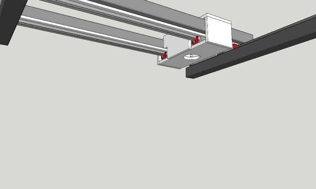

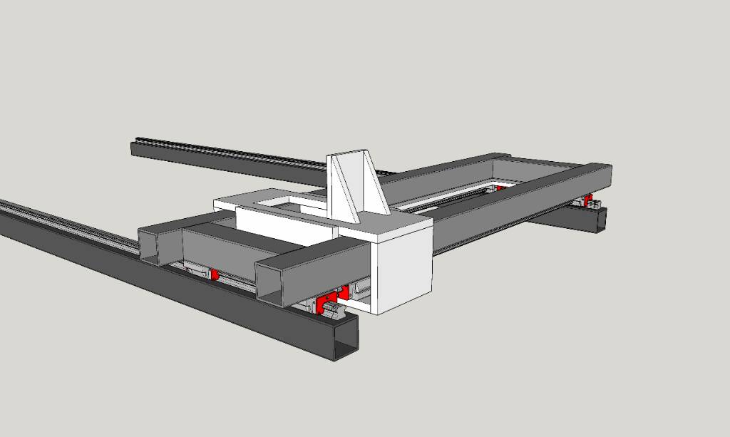

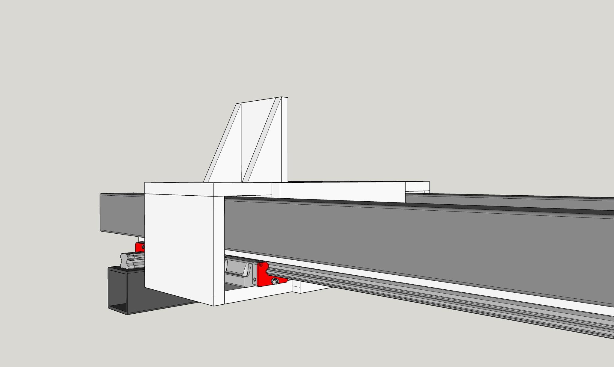

    Revision 5 of the Y axis with the beginnings of the Z axis too for your opinions on guys if possible. The Z axis is not finished, the upright plate will be mirrored to the other end and boxed in with the profiled rails mounted to it, the ballscrew will run internally on the same face.

  7. #87
    Looking nice, any chance you could extend the width that little bit more to allow for the plate, shaped like a T, to fit to the full width. This would allow you to box in the bearing units and then come up the sides and across the top as one plate, if you do that on both sides it makes the whole thing a box and so stronger all round.
    I like the way your going with it though
    .Me
