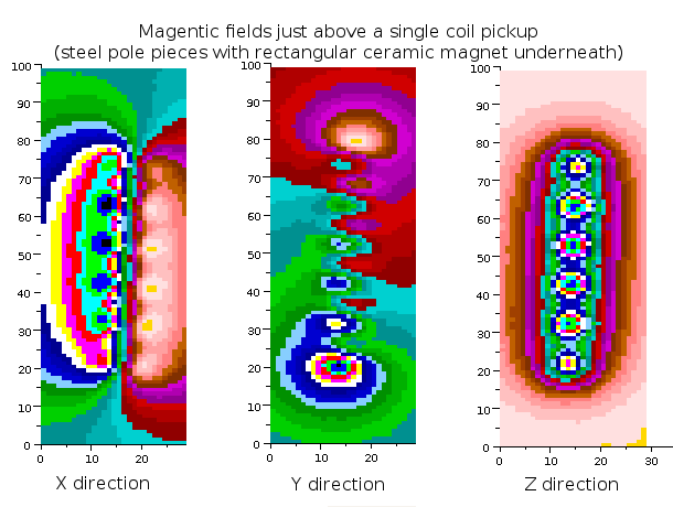

    Nice pickups Gregor! Have you got a CNC coil winder too?
    I used my cnc router & 3 hall sensors to scan a pickup's magnetic field. The one and only benefit of having a rubbish MDF machine is that it does not distort the magnetic field!
    Link to project

    Hi NB70
    No I don't use the cnc to wind pickups I have made a pickup winder so I can scatter wind them it takes about 6mins to wind them at about 1200 rpm
