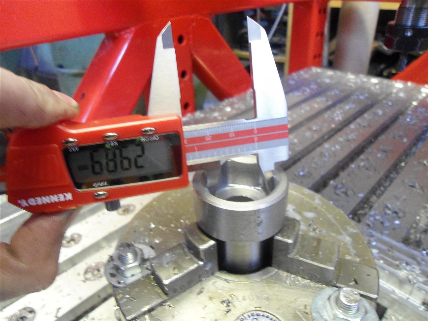

    Something along the lines of my spindle lock mechanism here?
    The plan ultimately is to use it with this part...

    You can guess the rest.
    Missed that post first time round so thank you for that Jonathan! Yes, something like that.
