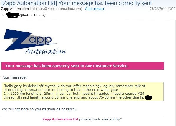

    i thought chia did this rail i was going to ask him if he,d thread it, still waiting on a reply from zapps,cheers
  5. Ive not seen any request for a price on this.
    Sorry, this is not something we are interested in doing.
    Quote Originally Posted by Gary View Post
    hello gary
    this is the confirmation i got after mailing you.your normally quite prompt with the replys so i just assumed you wasnt interested,no worries
