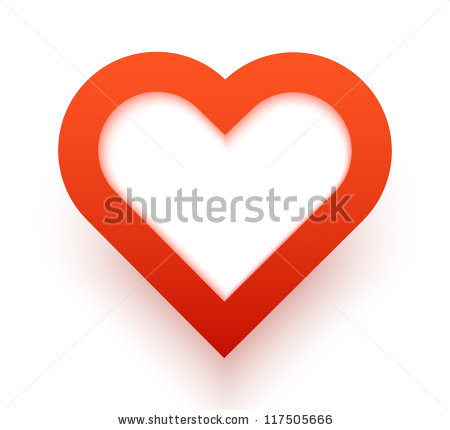

    hi i wounder if someone can help me please.i am trying to cut a perfect hart shape out. every time i try and cut one out come out not very good at all,i am using v carve pro to trace bitmap the out line but it never traces perfect am i doing something wrong ? many thanks for your help
    Hi, if you upload the bitmap I will try it in vcarve also to give you a comparison if you want
    Hi Bazzer here it is thanks for having a lookClick image for larger version.

    i dont know anthing about v carve but for better results can you not just draw a vector line around half of it and then mirror that vector left or right then sellect all.. save vector.
    Try this vcarve file

    I needed to draw a heart shape recently to use with vCarve and I found it more difficult than I expected. I think I ended up using a vector graphics application so I could tweak the curve, then mirrored it.

    Going back to the original question - I've never had much success tracing bitmaps with software. Probably a mix of incompetence and inexperience, as it's not something I need to do very often, but as long as the shape isn't too complicated I've usually managed to import a bitmap and then draw and edit curves over it, possibly even as a series of short straight lines. Might be an alternative approach for a quick-and-dirty solution especially in wood where a quick run round with a bit of sandpaper takes out any lumps and bumps.

    As for bitmap to structured drawing I've found that most "trace" routines give less than perfect results unless the resolution is increased massively and then processed, then manually edited, and you still get over-complicated geometry. I suspect it's far better to use a CAD package which allows you to have the processed image in the background and construct your own geometry - a capability which came into consideration when adding Bob Art in my initial BobCadCam order,
