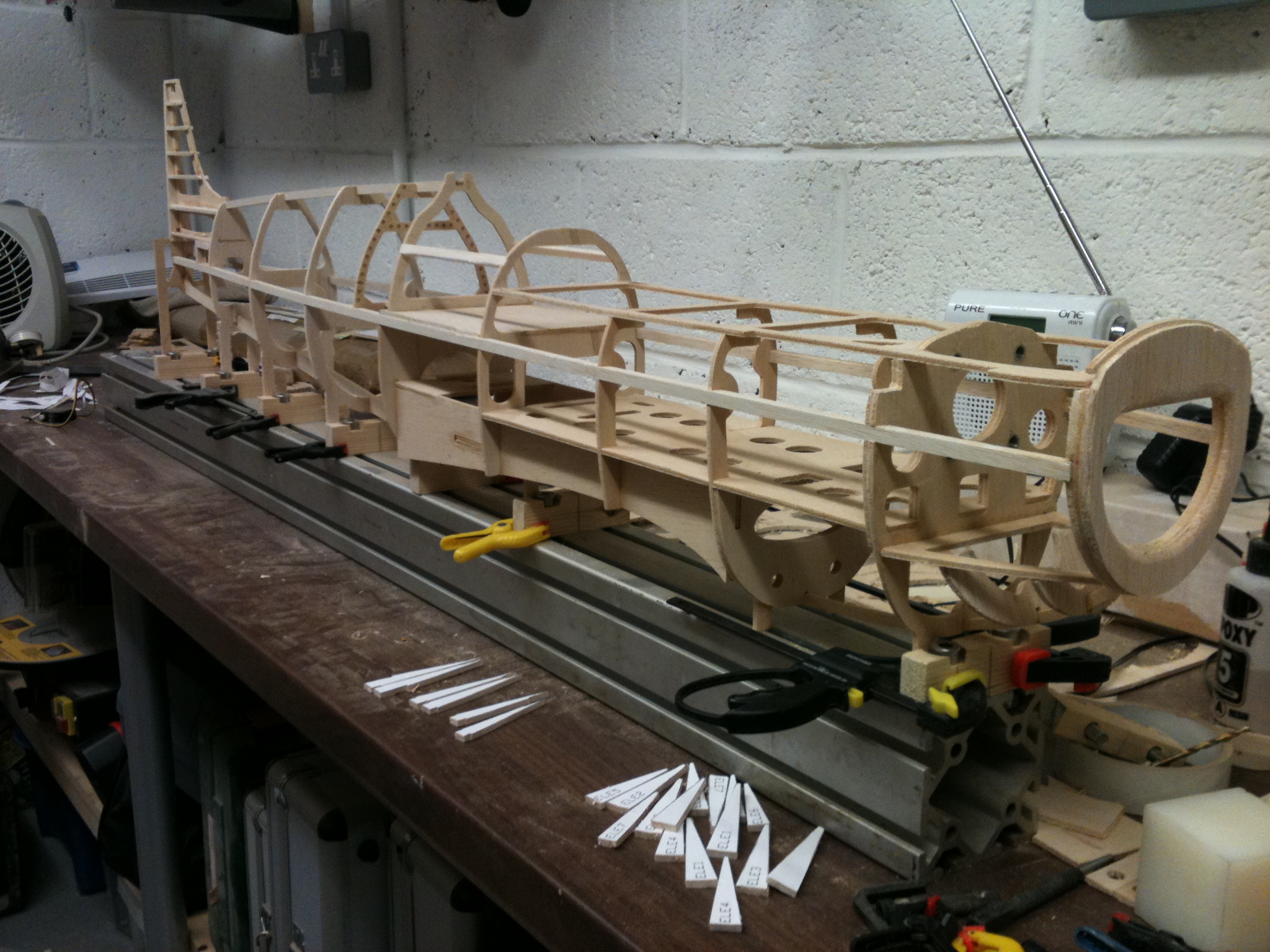

    Doesn't seem like a particularly heavy cut so it's a bit odd that one. I cut a fair bit of 3mm ply, liteply, and the occasional bit of MDF and use a single flute 3mm TCT router bit without problems. Here is my home design Spitfire which all locks together nicely . . .

    That Spit looks like it going to be lovely - which Mk are you going for?
    Sorry for the hijack....I have a thing for Spitfires (except maybe the Mk5 with that intake)
