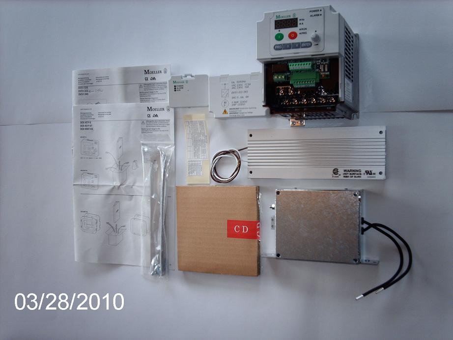

    Here's my VFD (top right), mains filter (bottom right), and brake resistor (middle) which was a waste of money (£50) as I never used it since the spindle stops pretty quickly without it.
