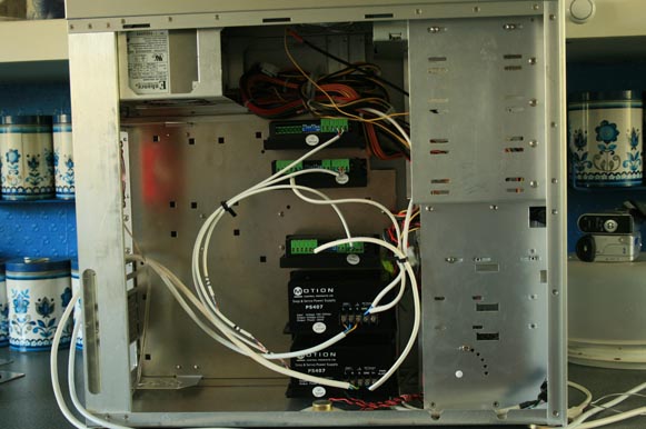

    Some photos... Work in progress on my control box. Hopefully just enough space for a mini itx mobo, my smooth stepper and a DIY cnc BOB. Hopefully in the end everything will be panel mount plugs so I won't have to run cables out of the box itself. Also I had a window on the case when it was used as a workstation, still quite handy I think :).
    Lastly one of the router itself. My brother has commented on how un-aesthetically pleasing it is. I disagree :D.

    Looking good so far Dave!
    Yea I looked into the market and noticed there wasn’t anything on the market so to speak for mounting ball nuts in a nice easy solution like the SMA units for instance, sure people like kip can machine their own but for people like you, me and so on there really wasn’t much if any choice, so that’s when I pointed it out to Gary that such a product is/could be desirable for people.
    Gary then took it all the way to China and now we have a choice/solution, so hats off to Gary for making it happen! The ball nut housings have only be listed for sale recently so don’t feel so bad :).
    Ill post up the build log for my controller box later today, need to get some work done first, I have solutions in that build aimed at you Dave so keep an eye out for it (mini itx mob, smooth stepper and BOB).
    Catch you later!

    Regarding wiring and ac power in, do you think its wise to have one source in and then run 3 drivers + spindle and a coolant pump off one source? I suppose there will be a computer in there at some point as well. There should be enough juice right?

    Yup... that is another thing to add to the to do list. Get fuses and fuse holder. Any idea where I could get one of those?

    lol, looks like 1 part to me to, also you can get the IEC's from maplins they are like what £1 ?, i just mounted one into the back of the case.
    EDIT: Have you engraved somthing into the side of it as well kip ?
