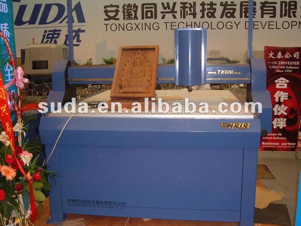

    Shapebuster: Sorry don't know the make but Like others say it looks like chinese type machine but resonably well built, thou if that is the price then it's not really worth that sort of money unless it's fully working with Tool changer and Vacuum pump pump and even then I think it's not overly cheap.
    From what i have looked its as similarities to this one dont you think?

    Maybe Its a older model of this SUDA VG1325 cnc router, from ONGXING TECHNOLOGY DEVELOPMENT Co
    http://www.sudacnc.cn/offer/526836431.html
    https://www.youtube.com/watch?v=EHYUWLCrrI8
    With this specs:http://www.txgm.dpes.com.cn/product/2011/12/278.html
    What do you think?

    Yes that looks very much like the machine doesn't it. I noticed the weight is 1250Kg which i would say is more realistic than 750Kg. That's not overly heavy so should move it easy enough.
