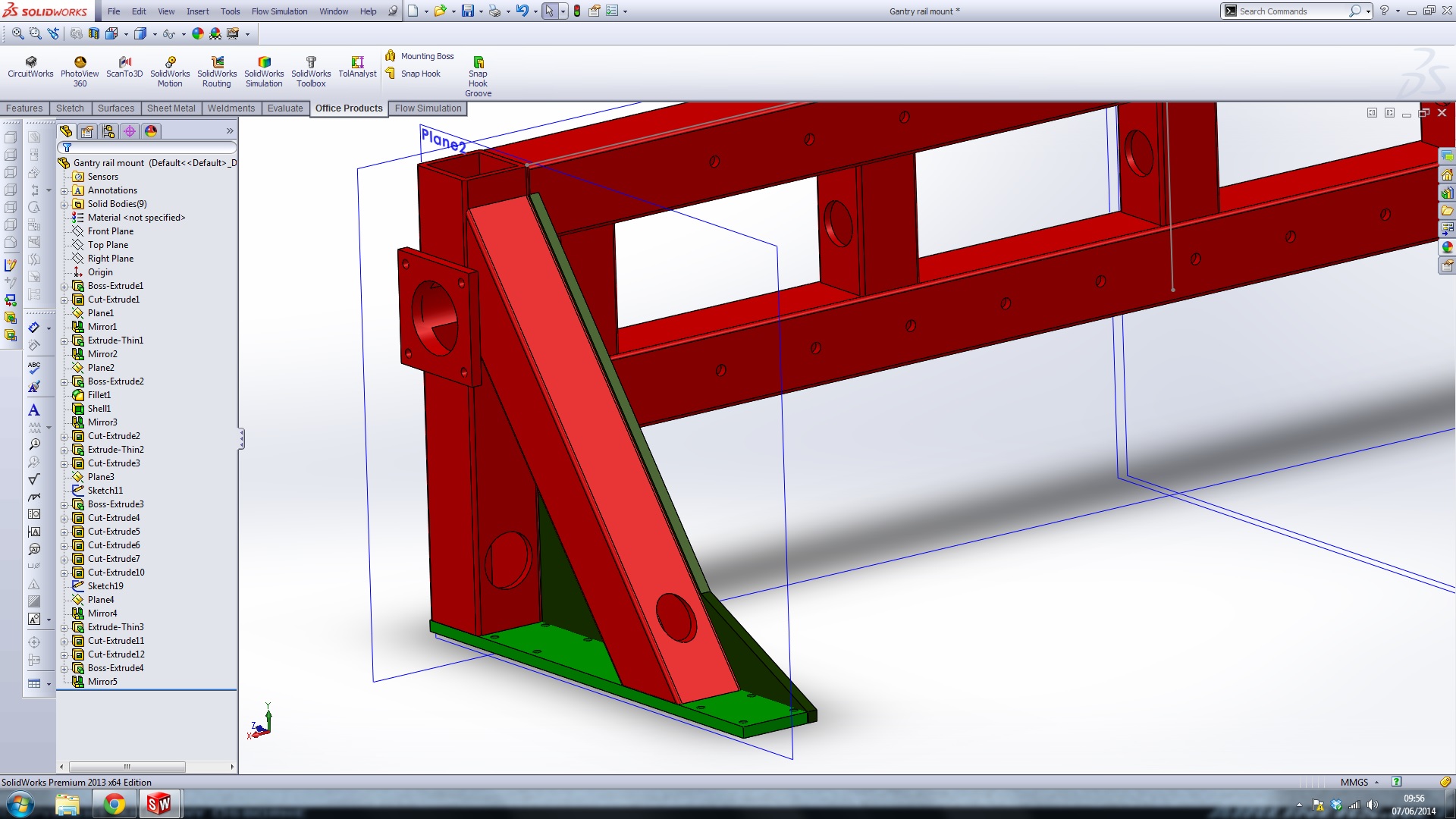

Im revamping my old design, the frame im happy with...i cant see there being much wrong with it after i strengthen it which was the main critique with it. So I have stiffened that up now. Also the gantry is sitffened up which I will show later, mian change is 2 pieces of 6mm plate welded onto the box section and did away with angle Iron(Which I call L Bar) where the Lbar was is now replaced with 6mm steel welded onto the boxsection
Green is 6mm plate, Note, I will need to extend the bottom 6mmplate awayslightly to make room for the bolts close to the vetical 6mm piece

As a matter of interest have you thought about how you will fix the ball nut and bracket to drive the Y axis it seems you are running the screw through the uprights in the gantry. Also there are cheaper places to buy belts and pulleys. ..Clive

Yeah I realised that haha, Did it at half 7, Ill put it to the mrning haha, those uprights in the gantry will be behind the horizontal box sections

Your gantry is looking slightly better but still needs work. Also by the looks of it you haven't given much thought to how the ballscrew end bearings will mount and how the motor will connect.? Has it stands now it can't be done without special machining and using FF/FK bearing blocks.
10mm plate would be better for the bearing plate 6mm is still a bit flimsy.! Can't afford any flex or resonance here.
