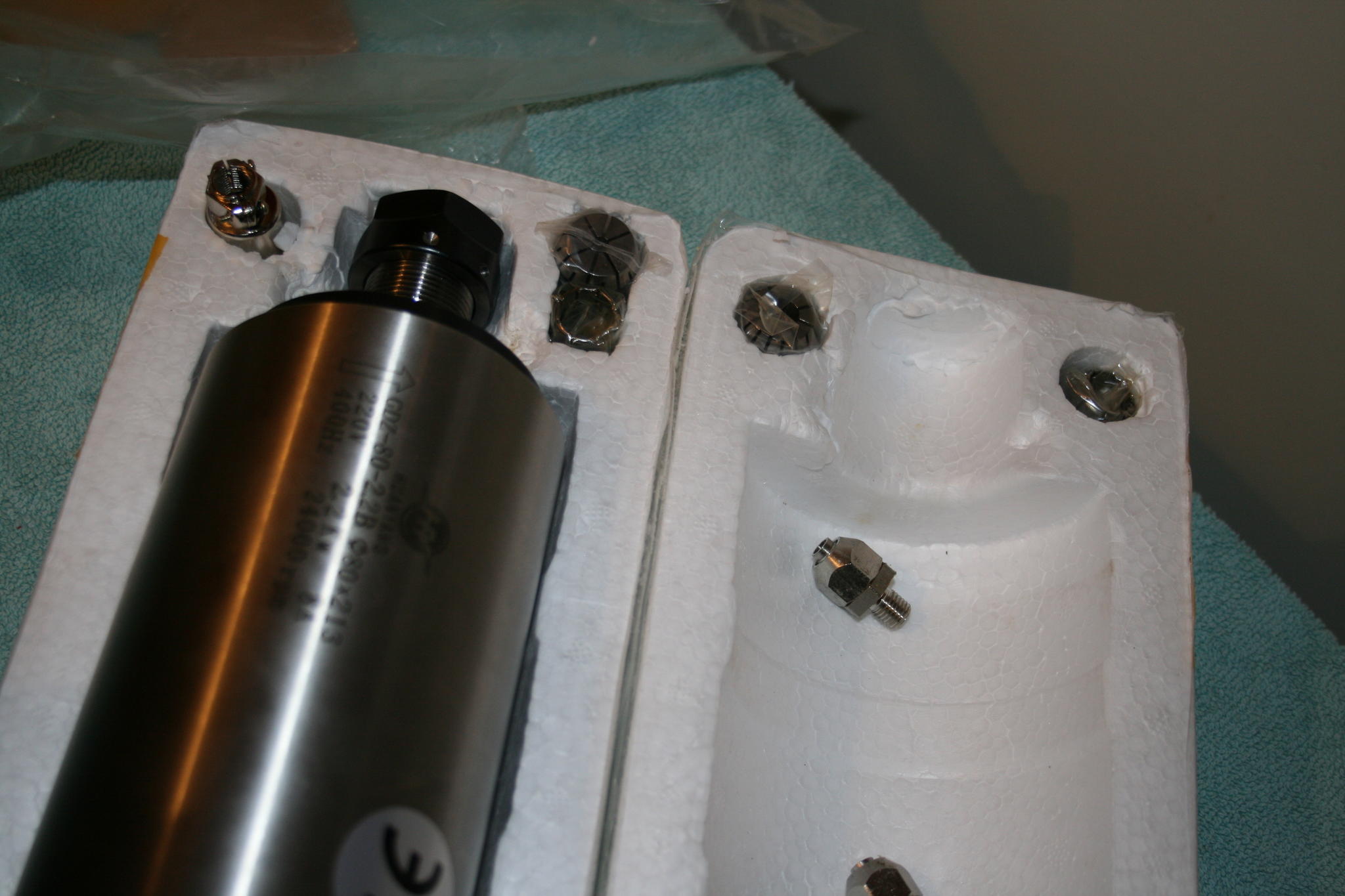

    i have 4 core 1.5mm sqrd. cy cable on order for the steppers, is there a recommended cable for the spindle?http://2.2KW WATER COOLED SPINDLE MO... OWNING | eBay.
  14. #109
    Quote Originally Posted by PAULRO View Post
    Same cable will work if you have ordered enough. Either don't use one of the cores or use the 4th core for an earth if you want. Personaly I don't bother with earth on spindle and just don't use 4th core.
  15. The Following User Says Thank You to JAZZCNC For This Useful Post:
  16. #110
    While the cable you have would work, and many people use that I'm sure, if you look in the manuals for 2.2kw drives you will see that 2.5mm^2 is generally recommended.
    Also I think it's a good idea to take an earth directly to the spindle because if you have a motor to earth fault a lot of current will flow, if you don't have an earth wire it could flow though the bearings finding a path to earth and this could ruin them. If you were selling these things commercially they would have to meet regulations which most likely also encompass manufacturers recommendations, but if it's for yoursefl then you have to decide how far you want to go.
