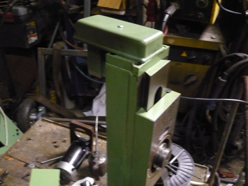

    Anyway, now I am at the stage of doing the Z axis. I've taken the old leadscrew out, luckily the existing ballnut support can be reused, no need to machine a new one as the standard ballnut with the six bolts fits perfectly in the hole (though only using 4 of the bolts).

    Today I fitted the Z axis ballscrew. I had to drill the top of the column, a hole of about 18mm. it wasn’t fun as my drill bits only go up to 12mm, and it takes forever to enlarge the hole with a Dremel. Then I remembered I had these cone shaped drills that drill in ever larger steps. Thereafter it was a piece of cake.
    I haven’t machined the top plate yet, but by connecting the FK12 at the top plus a handy little lever I made to crank the ballscrew in both directions, I could get a rough idea of the effort needed by the motor.
