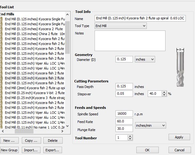

    All the bits i use are only Kyocera bits from him, unbeatable price quality. Funny that they are the cheapest around. The seller is fast and packet comes for 5 days to Spain from USA.

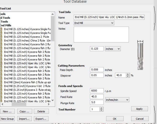

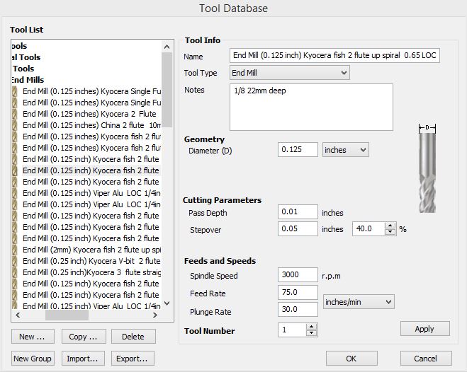

    Now back on the plastic. I posted it before, so just dug it out. I dont know what is your machine . Mine is very flimsy. So these should work 100% on any machine. Treat ABS as Plexiglas.
    Plastic likes sharp bits.
    Depth of cut is crucial for melting the plastic. You can just use the suggested speeds and speeds slowly raising the depth of cut until you are happy.
    Everything in imperial,1/8 or 1/4 it doesn't matter as usually the machine is the limiting factor here , not the bit , though more careful with longer or thinner bits :
    soft plastic , its scratching but if you go deeper with flimsy machine, it melts.
    Attachment 10779
    plexiglass

    MDF,wood, works for phenolic plastic also, composite panel

    These are excellent resources for me, thank you!
    Once the bit is delivered I'll run it with the correct parameters and see how it goes.
    Thank you both very much!
